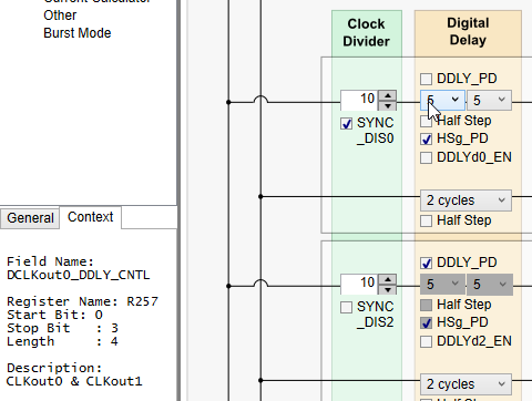

We can see the description about DCLKoutX_DDLY_CNTH/_CNTL in the datasheet, but can't the description in the TICS pro.

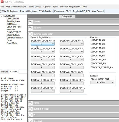

In the TICS pro, we can see DCLKoutX_DDLYd_CNTH/_CNTL instead.
Is it OK that DCLKoutX_DDLY_CNTH/_CNTL and DCLKoutX_DDLYd_CNTH/_CNTL are same meaning and the deiffernce is just a typo?
Noriyuki Takahashi
  • It's not just typos - these are separate fields.
    One set of fields (DCLKoutX_DDLY_CNTH/_CNTL) controls the fixed delay which is inserted during a divider synchronization event. In TICS Pro, these fields are located in the delay column. See datasheet section 9.3.3.1 Fixed Digital Delay for details.
    The other set of fields (DCLKoutX_DDLYd_CNTH/_CNTL) controls the dynamic delay adjustment. During a dynamic digital delay event (triggered by writing DDLYd_STEP_CNT while DDLYdX_EN = 1 for the chosen channel or channels), the divider temporarily outputs logic HIGH for DCLKoutX_DDLYd_CNTH VCO cycles, and logic LOW for DCLKoutX_DDLYd_CNTL VCO cycles. See datasheet section 9.3.3.2 Dynamic Digital Delay for details.
