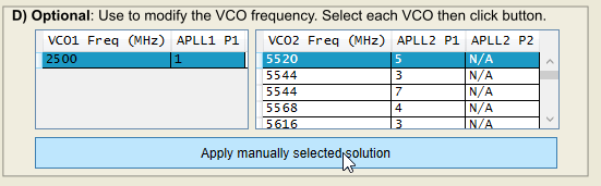

* Under "Set Outputs" it's not possible to select a different frequency plan. I found no way to select them under "D)"

    For bullet #2, can you share a screenshot? If there is more than 1 freq plan, then several options show up like below. Select an option from each VCO then click the button.
    There's a lot about tables that doesn't work the same as all the other visual controls like comboboxes or checkboxes. The API-level interactions with tables were never defined, because it doesn't come up often in our use cases. Consequently, there's no workaround for this issue.
    I think what should be done is:
    • Add GetTable API, which sends the contents of the table over the wire as a TSV string, and unpacks it as some straightforward python data structure (dict of lists with column header keys, probably)
    • Support GetIndex and SetIndex to get and set the table row
    • Add mouseover event to display name for tables in context window
    I'll see what can be done about this. I'm confident mouseover events and GetTable are straightforward; get/set index for table row may need to be different APIs.

  • I've updated the application binary with several improvements to both the server-side APIs and the ti_ticspro library:
    • GetTableData API returns table data as a TSV string; optional boolean argument specifies whether to include header row as the first row.
    • ExportRegisters and ImportRegisters APIs added. They both take a single argument, a full path to a file to import/export.
    • GetIndex/SetIndex now get and set the table row.
    • GetAllRegisters API added, which gets the current state of the TICS Pro register map cache as three lists: a list of register names (string), a list of register addresses (int), and a list of register data (also int). The register data is just the data portion of the register, as opposed to the weird concatenated value returned by export and ingested by import function.
    • ReadAllRegisters API updated to return the same three lists as GetAllRegisters API, after doing readback I/O.
    • CloseTICSPro API added which closes the application approximately 250ms after invoking the API.
    • Mouseover of tables shows the table API name in TICS Pro context panel.
