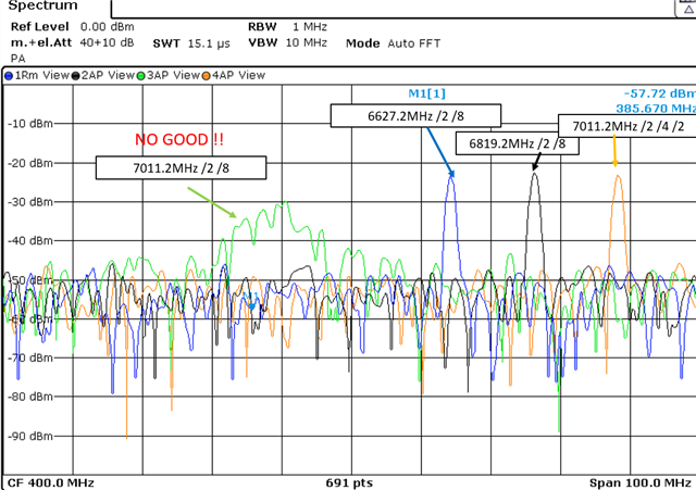

Some of LMX2582 devices do not divide correctly 7011.2MHz VCO, under the settings of CHDIV_SEG1: divide-by2, CHDIV_SEG2: divide-by8, CHDIV_SEG3: - (REG35: 0x109B, REG36: 0x0420). Others devices divide correctly.
In both cases, lock detectors indicate 'Locked', so output diviers seem not work correctly in some devices.
When I change the divider settings to CHDIV_SEG1: divide-by2, CHDIV_SEG2: divide-by4, CHDIV_SEG3: divide-by2 (REG35: 0x059B, REG36: 0x0441), devices work correctly.
At VCO frequency of 6627.2MHz, 6819MHz diveices work correctly.
Are these defective or does  the divider have operating conditions?

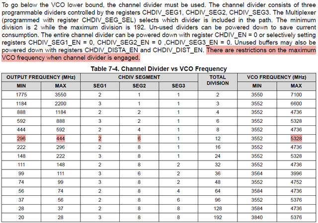

  • Hi Ashida-san,
    If you need 4xx MHz, you should use a lower VCO frequency. Datasheet has the following:
  • Dear Fung,
    Thank you for your comment.
    Does VCO FREQUENCY in table 7-4 show the restrictions on the maximum VCO frequency?
    If so, in 2020 (before datasheet revision E is not issued..), using SEG1=2, SEG2=2 for 1414MHz output is accepted.
    e2e.ti.com/.../
    Is this use case not acceptable now?
  • Dear Fung,
    The Table7-4 suggests the setting of SEG1=3, SEG2=1, SEG3=1, in case of 1540MHz output.
    I tried with 2 settngs.
    Dividers do not work correctly with setting of SEG1=3, SEG2=1, SEG3=1 and VCO=4620MHz, but dividers work correctly with setting of SEG1=2, SEG2=2, SEG3=1 and VCO=6160MHz.
    The former setting is within the range of the table7-4, and the latter setting is outside of the range.
    What shoul I refer to ??

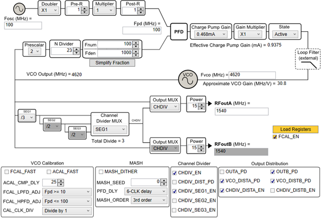

  • Hi Ashida-san,
    My board works with both configurations.
    With SEG1=3, SEG2=1, SEG3=1 and VCO = 4620MHz, are you not getting output in all devices or only in the same devices that you have reported having issues?
    FYI, below is the register setting in my setup.

  • Dear Fung,
    I am sorry for my miss judgement. My boards work with both configurations. The problem is in the following circuit.
    The output of LMX2582 drives a quadrature generator with a divide-by-2 method. I need  180-15400MHz output from divide-by-2/4/8. A divide-by3 output causes a large quadrature phase error in the following circuit.
    Are cofigurations such as SEG1=2, SEG2=2 and 1184-1540MHz of output frequecy available?
    e2e.ti.com/.../
  • Hi Ashida-san,
    So your problem is your system is not happy with odd divider output, this makes sense.
    If your required frequencies are between 1184MHz and 1540MHz, I think it is fine to use SEG1=SEG2=2 to get divide by 4.
  • Dear Fung,
    Of course, I want to use SEG1=SEG2=2 for over 1184MHz. But you mention about the restrictions of the maximum VCO frequency for each divider, and output frequency over 1184MHz with SEG1=SEG2=2 is outside of the range of Table7-4. Is this configuration is acceptable ??
  • Hi Ashida-san,
    The max. input frequency to SEG2 is approx. 3.3GHz. So SEG1=SEG2=2 is a valid configuration, as long as the output frequency is limited to 1540MHz.
    In general, we recommend follow Table 7-4, this would return predictable result.
  • Dear Fung,
    Thank you for information about the max. input frequency to SEG2 . I use SEG1=SEG2=2 configuration. for 1184-1540MHz without worry.
