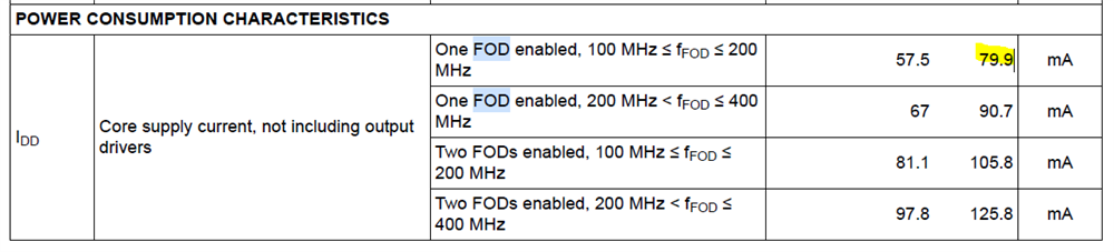

Part Number: LMK3H0102
If both outputs of the CLKGEN are 100 MHz, the maximum IDD current is 79.9 mA?
Thanks!

Jeff,
This is correct, inclusive of supply voltage and temperature. Note that this does not include IDDO_x, only IDD.
