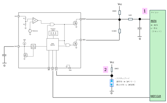

I am Nakasuji.
I have two questions about how to use the TPS3851H50EDRBR.
1,Microcontroller side, I would like to receive it on one INPUT.
   Is it okay to connect it as shown in the diagram No.1?
2,I would like to use the SET1 pin as an enable.
 I only want to disable it when using the debugger.
   Normal time: H      Disable: L
 Is it okay to connect it as shown in the diagram No.2?
