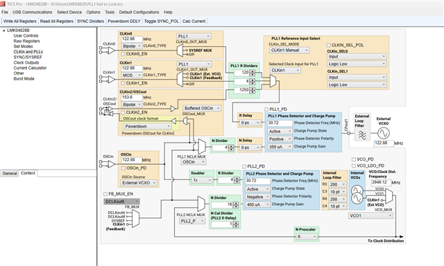

           I have a question in regard to the PLL1 and PLL2 of the LMK04828B IC.

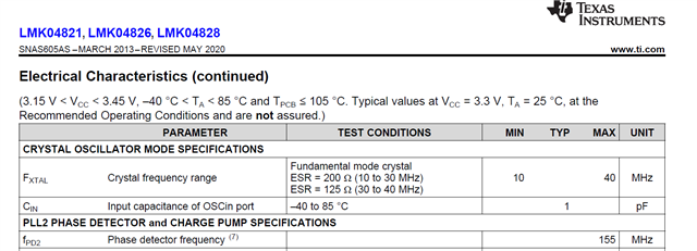

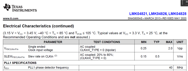

           Per the specifications, PLL1 phase detector frequency is spec-ed to be 40 MHz maximum, while PLL2 phase detector frequency is 155 MHz max.
            However I only managed to configure them to be outside of spec to obtain the PLL locks (i.e. PLL1 & PLL2 phase detectors @ 122.88 MHz and).
            Any  other configuration I do to ensure PLL1 and PLL2 detectors to be within spec causes PLL1 to fail to lock.
            Can I check if there is an error in the datasheet (or I have an older version) that explains the behavior I am seeing?
            Attached are some TIcProSW configuration files that shows both my configuration whereby PLL1, PLL2 locks (refer to "PLL1_PLL2_Locks.tcs") and PLL1 fails to lock (refer to "PLL1 Fail to Lock.tcs").
            I am trying to understand where the discrepancies are or there is something I am missing that explains the behavior I am seeing.
            Any help you can provide is appreciated.
           Thank you.
TaiPLL1_PLL2_Locks.tcsPLL1 Fail to Lock.tcs
  • Hi Tai,
    Currently you have PLL1 PFD to 30.72MHz as well as PLL2 PFD.
    This config should result in lock.
    In the case for PLL2, I increased the PFD frequency to 122.88MHz to gain a few db in the PLL region of the output PN.
    Vicente
    PLL1 Fail to Lock revised.tcs

  • Hi Tai,
    I took this into the lab to try to replicate the issue. Something seems off with your configuration file because even when I used PFD1 values within spec, I did not see PLL1 lock. However, when I used the default configuration in TICS Pro, adjusted the SYSREF settings and outputs (which I would recommend you changing as you see fit), I managed to achieve lock with both PLL1 and PLL2. Some registers may have gotten set inappropriately, but I am not sure how that would have allowed PLL1 to lock at a frequency beyond spec.

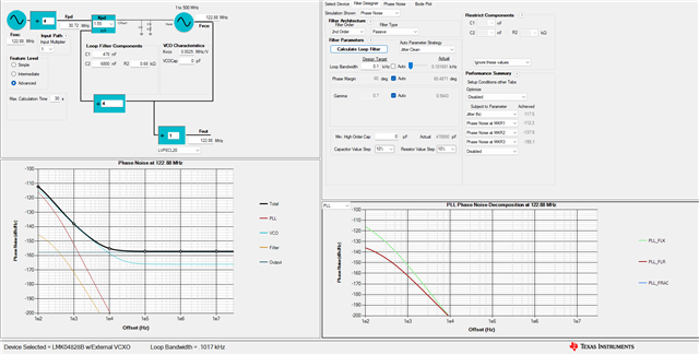

  • Hi Tai,
    PLL1 could be prevented from locking by a few external design choices. The main factors that would result in PLL1 being unable to lock is the on-board VCXO value being wrong, the dividers being incorrect relating to PFD1, or the loop filter for PLL1 being set incorrectly.
    The most basic choice for the loop filter (of the 2nd order variety) can be seen in the Pllatinum Sim screen attached.
    Beyond these, incorrect input matching or input path layout issues could result in loss of lock - but given that you are using a pre-designed card, I would not initially suspect these being the contributing issues.
    Michael
