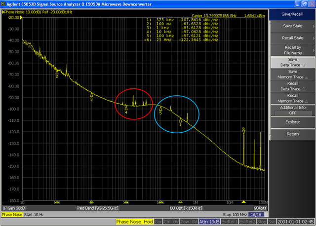

Good afternoon,
We are using the LMX2595 to generate a 13.75 GHz tone. For this, we use a 25 MHz reference (we cannot change it, as the system design requires it to be 25 MHz). The problem is that when we measure the phase noise, we observe spurs between 10–40 kHz (marked in red) that we have not been able to eliminate.

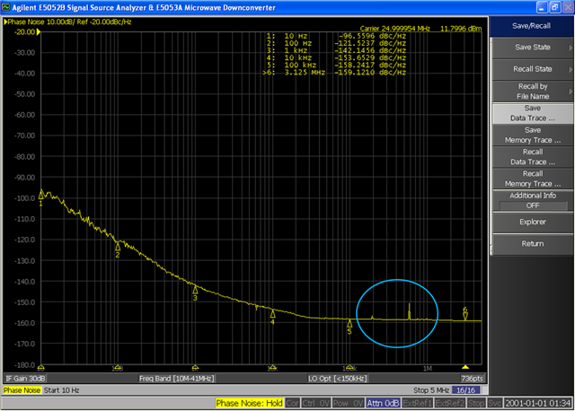

The spurs I marked in blue (200 and 600 kHz) seem to come from the 25 MHz signal we are using as a reference. I am also attaching the phase noise measurement of the reference.
We are programming the LMX2595 using Arduino, and these are the registers we are modifying:

We are not using any DC-DC converter or LDO to power the LMX2595. Do you know how these spurs could be generated?
Thanks in advance.
Gabriel.
  • Hi Gabriel,
    25MHz input, 13.75GHz output is an integer channel, PLL_NUM = 0, there is no fractional spurs. The spurs you observed should be coming from the environment. Power supply and reference clock are the major contributors to these spurs. It could also be the result from pcb layout. if you have some switching signal traces around the PLL, the PLL may get contaminated.
