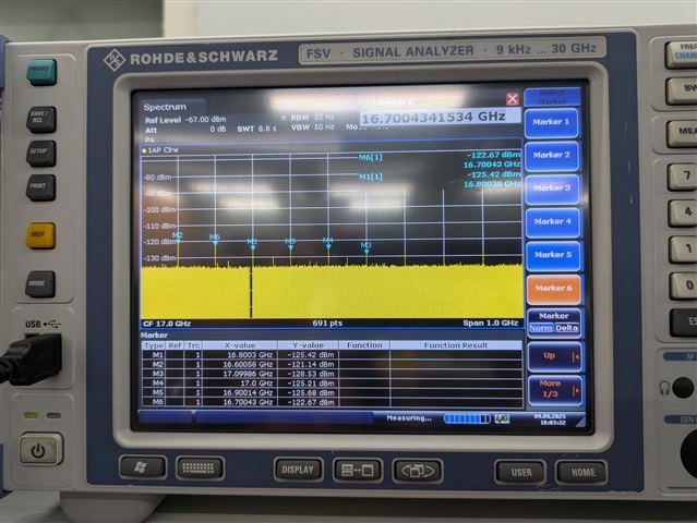

this my configuration file for lmx2595, I programmed it to 10.9 GHz. and I'm observing its spurious power in wide band. and this is what I'm observing in the spectrum analyser.
How to reduce this spurious power to less than -140 dBm.
  • Hi There,
    The spurs power is already very low, I don't have pin-pointing idea to reduce the power further. It is going to be an trial-and-error work.
    For example, use ferrite beans, change Vcc bypass capacitor values.
    You can also try, after the synthesizer is locked, set R2[10] = 0, this will stop the state machine clock, which is equal to fosc / 2^CAL_CLK_DIV. Remember to set this bit back to =1 before another VCO calibration starts.
