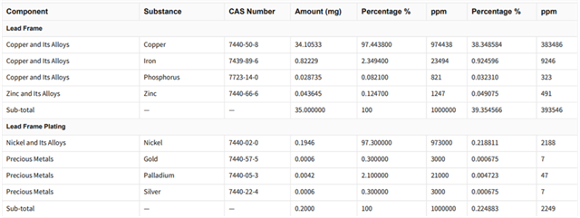

Hi Andrew,
Hi Noel,
Thanks for sharing, but I'm unable to easily translate this directly into a plating thickness. Do you have this information?
Andrew
Ni 10uin min, Pd 0.2uin min, and AuAg 0.2uin min.
Perfect, thanks!
