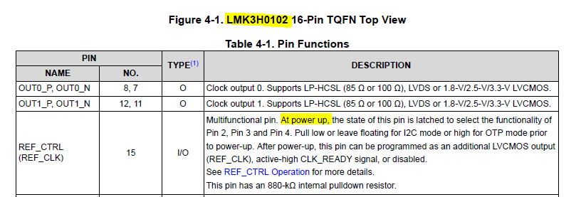

Part Number: LMK3H0102
What's the latch time at power-up mentioned by CLKGEN?
In other words, after VDDO comes up, within what time window will a detected HIGH be treated as the power-up state?"

Jeff,
This pin is sampled and latched after a few hundered us. In general, we recommend having either a pull-up or pull-down to set the state of the pin.
Kadeem
