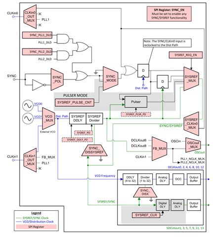

From LMK04828 datasheet I know that SYNC pin and CLKin0 pin both go to the same SYNC/SYSREF path
this path can reset SYSREF and CLKout dividers as one can see on the scheme above.
But from "Multi-Clock Synchronization" I can get information that one can acheive 0-delay not only with PLL setups with integer N/R but also in fractional cases, if resets N and R dividers on parallel clock devices.
So I am curious if SYNC pin has some functionality, CLKin0 input does not have. Like reseting R and N dividers, for example.
  • Hello Lazba,
    LMK04828 does not have the PLL R divider reset.
    Only LMK04832 supports PLL R divider reset via the sync pin only.
    The CLKin pin cannot reset the PLL2 R divider.
    The sync pin has around ~3-5ns of prop delay compared to ~150ps of prop delay in CLKin0 pin.
