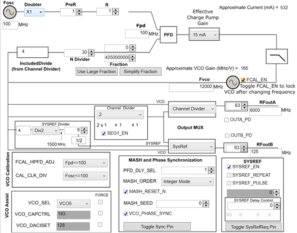

I was able to get an estimate of the current draw of our configuration, but I need some help understanding how to estimate a maximum power rating to show we are not overstressing the part.
So with our configuration and a Vs max of 3.38V we calculate 3.38V*.491A = 1.6W.
So I was wondering if our ambient temperature is max 55C, could I use PDmax=(TJmaxTA)/θJA -> PDmax=(125°C55°C)/22.7°C/W = 3.08W as an upper limit as to what the part can handle?
I tried doing various settings to find a max current draw, but that doesn't seem like a good way to find a upper limit to the power draw that we can compare against.
For reference we have a .75 derate on our power rating, so if we assume 3.6Vs and 500mA current draw = 1.8W, then after the derate that only allows us 1.3W of power. I feel the actual part can handle more, but Im not sure if the junction temperature is a good way to get a max upper limit or if there are other factors to consider.

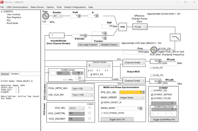

    FYI, this is the configuration with the highest current consumption.
  • Thank you for your reply. I believe to show a safe power rating I will use the Tj = ΨJB * Pd + Tb equation you show, and utilize our 90C simulated board temperature. This gives us about 4W of power we can safely dissipate, and with 3.38V and 490mA that's about 1.66W of power and I think that shows we are operating safely below the derated power of 4W*.75 = 3.45W.
    As for the output current, Im starting to think in regards to our parts derating for parts stress it must be more relevant to understand not how much current is consumed by the lmx chip, but rather that the load is not asking too much of the LMX output clocks.
    So we use both outputs to generate two 2500Mhz clocks. RFOUTA goes to the sample clock of a high speed ADC (U8-ADC12DJ3200QML-SP) and RFOUTB goes to FIN on the LMK04832 as the input reference clock. Both RFOUTA and RFOUTB are 50ohm impedance traces.
    The ADC CLK input has an internal 100ohm termination resistor, the LMK FIN0 input impedance seems less defined in the datasheet (we use that part in distribution mode).

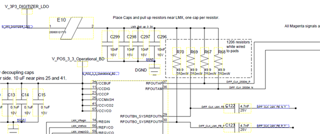

    If we assume 100ohm load for RFOUTA and 100ohm load for RFOUTB and the LMX open-collector driver has a 50ohm pullup resistor to 3.3V, then can we calculate that the expected output current is Ioutput=Vswing/Rload​ => Ioutput = 1V/100ohm = 10mA when the transistor is off and the signal is pulled high.
    When the transistor is on, we have measured about 55mA of current through each of those pullup resistors.
    Is there a way to know the current rating of the internal transistors? Since that would be when we draw the most current on the outputs?

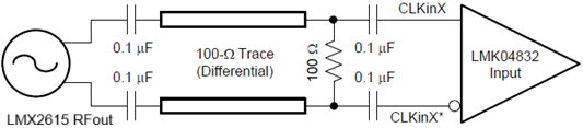

  • Hi Arooj,
    LMK04832 CLKin requires external termination for the driver.
    I don't understand the current rating questions, what do you want to figure out?

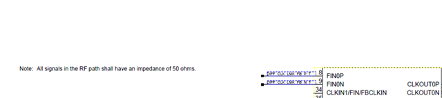

  • Hi, so RFOUTB goes to FIN0+/- on the LMK part, does that also need an external termination?

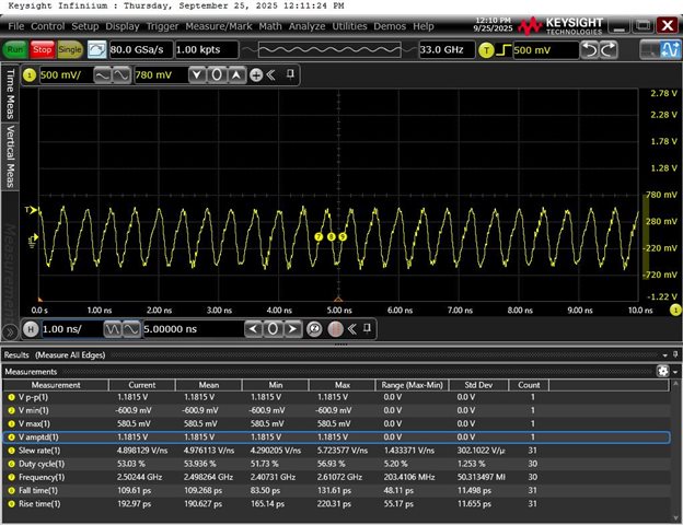

  • Hi again, I wanted to ping again about the FIN0+/- input pins and if those require external termination?
    Attached is a scope shot of what the clock signal from the LMX look like going into the LMK pins

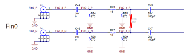

  • Hi Arooj,
    LMK04832 datasheet suggests use a resistive pad at Fin0 when the input frequency is high.
    From the user's guide, the eval board uses a 3dB pad at each pin.
    I suggest you can copy this design.

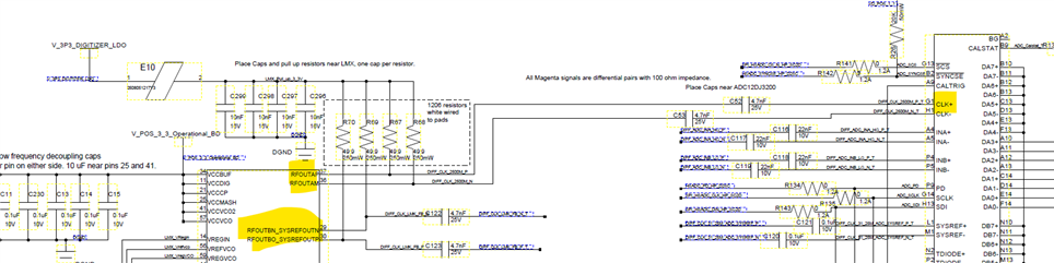

  • HI Arooj,
    How did you connect LMX RFoutB and LMK FIN0 together? I don't see that portion in your schematic.
  • Hi Arooj,
    With power setting of 63, I measured RFoutB swing is approx. 1Vpp on a 50Ω load. Your data shown the swing is 1.18Vpp, that means the input impedance of FIN0 is a bit higher than 50Ω. I think this is ok.
  • Thank you for doing this measurement. If it is assumed that we have an input impedance of slightly higher than 50 ohms on each pin, is it safe to say that I can calculate the output power using the following equation with Rload = 100ohms?
  • Hi Arooj,
    Rload here should be 50Ω as our measurement is single-ended.
  • Okay, understood for a single ended measurement it should be 50 ohms, but for a differential measurement it should be 100 ohms correct?
  • Hi Arooj,
    Correct, but V will be doubled in case of differential measurement.
