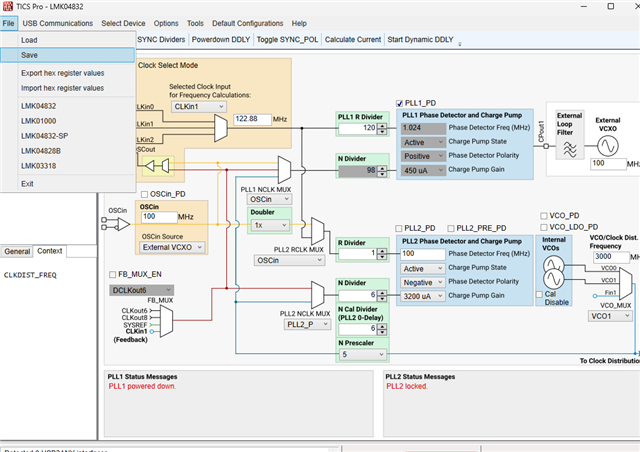

This is Dinesh from iWave Global. I have configured the frequencies based on my requirement but if I save and close it means, some configured frequencies are changed. So I can't save my configured clock file. Attached is the frequencies requirement and please let me know how to save clock file without changing the frequencies. Looking forward to the response.

    Are you saying if you save the configuration file (.tcs) and you reload it - your settings are different?
    If you actually load the file on an EVM - are the raw register settings different? It's possible you may be experiencing a GUI bug but the register content is correct.

  • Hi Dinesh,
    No, your frequency plan is not feasible.
    You need all your clocks to have an LCM that falls within the VCO coverage range this device supports.
    The issue here is the 156.25MHz clock and the 148.5MHz clock.
    The rest of the clocks can be generated from a 3GHz VCO frequency.
    You can also use the frequency planner.
    Only a device that can cover multiple frequencies domains at once like LMK05318B (a DPLL) can do this but our DPLLs are not available in Hi-Rel.
    Vicente

  • Hi Dinesh,
    No, your frequency plan isn't feasible due t o the 148.5MHz clock - are you willing or able to change this?

  • Hi Dinesh
    Only option unfortunately is a different kind of device like a DPLL as a jitter cleaner won't be able to produce outputs from two separate frequency domains.
    LMK05318B might be able to due to.
    None of our DPLLs are rad-hard though - just a quick fyi.
