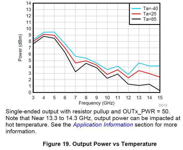

Regarding the output power graph (Fig19) in the data sheet of LMX2594, is this data obtained by EVM?
Also, is this the result of differential measurement?
-> If yes, is it correct to assume that it is about -3dbm at 14 GHz when measured at a single speed?
(Ta=25degC.)

    All power measurement is single-ended.

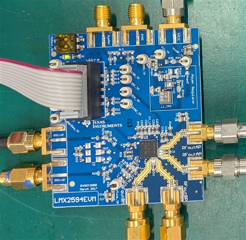

    Are you using a coaxal cable to connect the EVM and test equipment? I recommend use a SMA male-to-male connector instead of cable.
    The data in the plot is a typical data, it is normal that we may see variation over parts.

    The result is -2dBm compared to 2dBm, so the output power seems to be quite low.
    As for the connection, SMA connector and coaxial cable are used as shown in the attached picture.
    I also attach the configuration file.
    What else could be the cause of the low output power?

    My board is measured -0.2dBm on RFoutA, -1.7dBm on RFoutB. If you need higher output power at 14GHz, use RFoutA.
    There is nothing we can do in the configuration to increase the output power. We have to do it in pcb layout. For example, use coplannar waveguide for the RF traces, use low loss pcb material and use shorter trace. I have another board with very short trace, I can get 2dBm at 14GHz.

  • Hi Higa-san,
    I did not use cable.
    On the test equipment, I used a N-to-SMA (male) adapter, EVM was connected to the adapter directly.

  • Hi Higa-san,
    The unbalance between A and B is probably due to pcb layout and the external 50Ω pull up. At 14GHz, pcb layout as well as soldering becomes important. The position of the external 50Ω pull up will affect the output power. The amount of solder (for the pull up resistor) on the trace will also affect the impedance of the trace.

  • Hi Higa-san,
    There is no change to the pcb layout and material.
    Measurement at 14GHz requires very good test facility.
    Test equipment, cable, connector, adapter have to be able to support 14GHz.
    This device consumes over 400mA current, the power loss in the Vcc supply cable could matter. Make sure the voltage at Vcc_TP is 3.3V.
