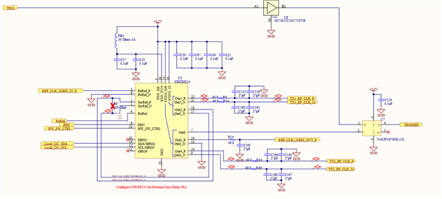

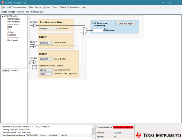

Hi Forum,

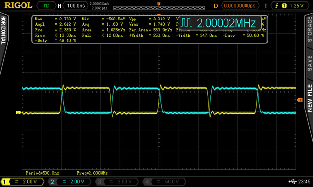

Above I have our current implementation of the clock IC.  We are getting the correct output frequencies but the output is inverted or 180 degrees out of phase.  We are using OUT3 to drive the next boards clock chip,  Below is the Refrence clock (Yellow signal) from the first board and the OUT3 (blue signal) going to the pri reference input on the next board.
 Zero delay mode is enabled and below is the register settings.

we need to get the input 2 MHz signal input and the output to be in phase.  Is there a way to do this?

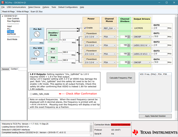

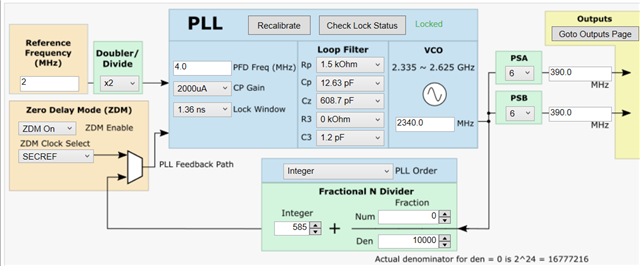

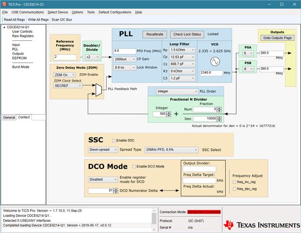

    I believe that I see the issue here. I load your settings into TICS Pro and see the following:
    The zero-delay mode is specifically for clocks that come from the PLL. When using REFCLK as the clock source, the clocks are not in zero-delay mode. The clock source for zero-delay must be from PSA or PSB.
    I also recommend increasing the PLL lock detect window from 1.36ns to 8.9ns for improved PLL locking, and change the PLL order from Fractional Order 1 to Integer.
    Kadeem

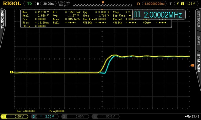

  • Hi Kadeem,
    Thank you for the information, I did update the feedback to us psa and increased the lock detect window time to 8.9ns and the system does lock now.  Below is the register values being used.  Now this does lock but if i power cycle it locks in different phases and never aligned to the reference clock.  The scope shots show the reference clock and blue is the OUT2 frequency.

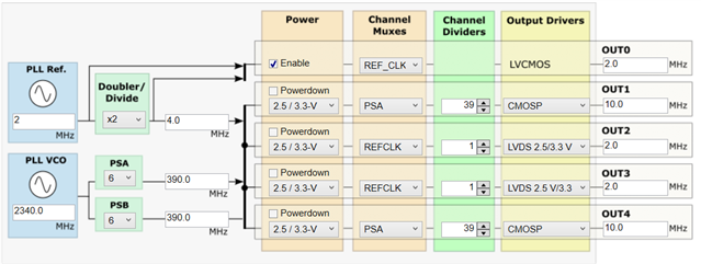

  • here is my config in the tool
  • George,
    Please change from using the doubler (change the "Doubler/Divide" block from x2 to /1), and double the integer divider (585 to 1170). Does it consistently lock in phase when this is done?
    Kadeem
  • making those changes seem to have the same result.  the clock ic datasheet specifies the reference clock to be 10-200 MHz can that be the issue we are using 2 MHz reference?

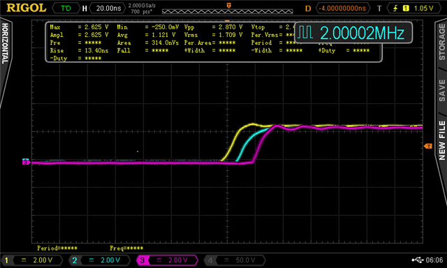

  • Hi Kadeem,
    I deffinitely appreciate all the help and now the clocks are deterministic.  The image below shows reference clock yellow, out3 on the first board is blue which drives the reference clock on the second board and the purple line is the out3 on the second board.  It is always the same offset and if i keep adding boards each output will be offset the same.  is there a way to configure that out?

  •  Hi Kadeem,
    The configuration file is attached.  The measurement is at pin-5 (yellow) for the ref clock and pin-14(blue) for the 2MHx output signal for OUT3
    Current_configuration.tcs
    Another issue on reference pin-5 (yellow) to OUT0 pin-7(blue) below are 180 out of phase.  The good thing is that every restart the results are always the same and it is running predictably.
