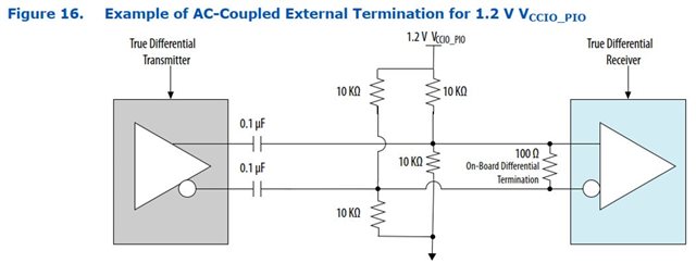

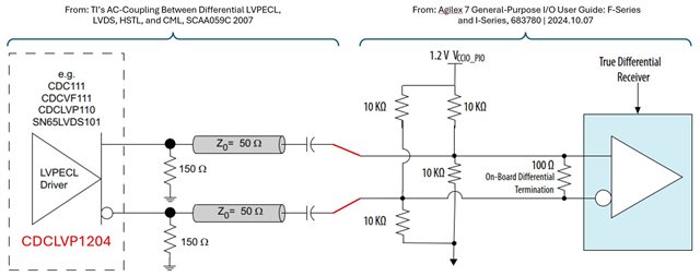

I'm updating a design and I want to connect an unused output from CDCLVP1204 (Vcc = 3.3 V) to a differential clock input on an Altera Agilex 7 FPGA in a 1.2 V bank. It is a 50 MHz clock.
Figure from: Agilex 7 General-Purpose I/O User Guide: F-Series and I-Series, 683780 | 2024.10.07

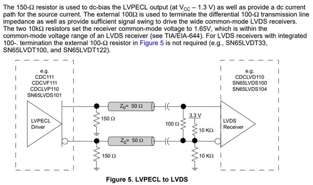

Figure from: TI’s AC-Coupling Between Differential LVPECL, LVDS, HSTL, and CML SCAA059C–2007
Combined figure:
Image showing the numbers don’t work:

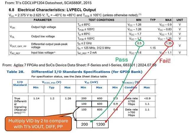

Can you provide a recommendation for connecting the two? Perhaps a voltage divider scheme?

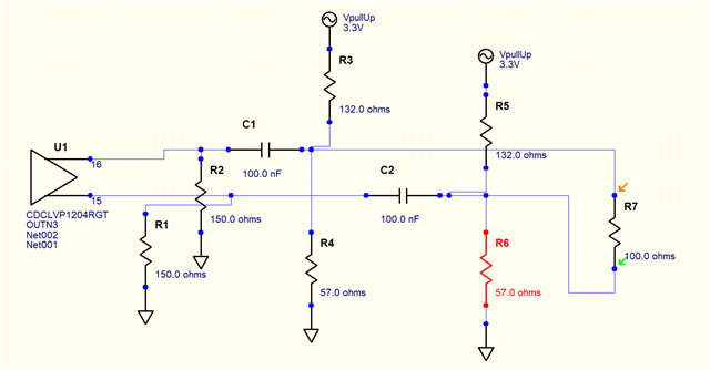

  • Hi Vicente,
    I want to learn how to reduce the peak-to-peak swing at the output of the CDCLVP1204 from 1.35 Vpp to something less than the FPGA's maximum of 1.2Vpp.  I don't understand how your circuit reduces the peak-to-peak swing at the receiver, can you explain or show a simulation plot?
    Rob
  • Hi Rob,
    Yes
    The 132 and 57 Ohm termination scheme is what reduces the scheme.
    Normally LVPECL expects a 50Ohm termination but in this case, I am using 40Ohms to reduce the swing.
    132 || 57  = ~40

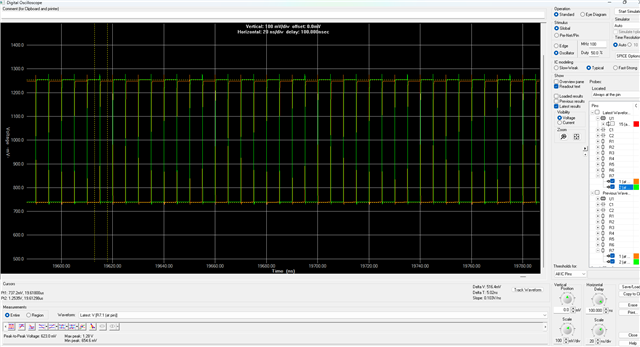

    Here is the plot.
