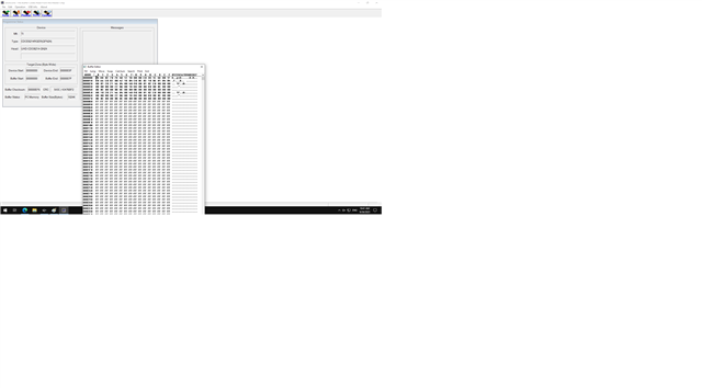

Accton VN product line feed back that P/N:CDCE6214RGER when we burnning it into our system, it failed that can not burnning in,
The material has data written but is incomplete (Verify Error), resulting in errors in CheckSUM and Bom. The CheckSUMs of 3 pieces read separately are inconsistent.
Screen Display OK show: Verify Complete,  Screen Display NG show: Verify Error
we input tatal : 3600pcs and found 12pcs NG, NG Rate: 0.33%, DPPM:3333,  D/C:2522
pls help to check the root cause, Thx
    So my understanding is that 3600 pcs were programmed, with 12 of them having this EEPROM programming issue? Is that correct?
    Can you provide the EEPROM configuration being programmed to the device?
    Can you provide an EEPROM readback of the 3 pcs checked?
