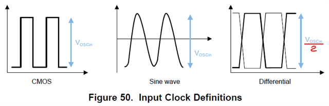

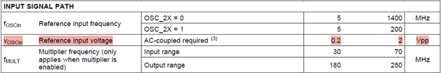

1. The datasheet does not specify the absolute minimum and maximum power ratings for the OSCinP and OSCinN pins. What are the recommended Min, Max & Typical values to be taken during design?
2. Can the Reference Clock input pins (OSCin) accept sine wave inputs?

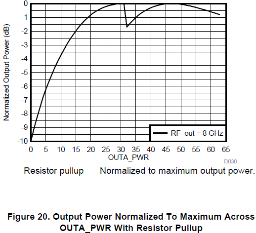

3. What is the minimum RF output power level that the device can reliably generate?
