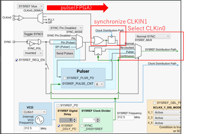

I would like to synchronize the pulse input from Clockin0 with Clockin1 (312.5MHz) on the LMK04832 and output it from Clockout9, 11, and 13.
It seems that the block diagram in TICS.Pro is set up correctly, but the Clockout is always Low. Clockin0 is a signal generated by the FPGA and is being input correctly.
Clockin1 is generating 312.5MHz from a second LMK04832 and is also being input correctly.
The settings are as follows, but is there any additional configuration needed?

  • Shunya-san,
    I took a look through your configuration, and it all seems correct - you have CLKin0 going to the SYSREF mux, which is re-clocked through the SYSREF path based on the setting of SYSREF_MUX = 0 and SYNC_MODE = 0.
    I notice one critical issue - your SYSREF_PD bit is not set. Not setting this bit means that SYSREF is generating a signal based on the 312.5MHz signal that is distributed from CLKin1. By setting this bit, SYSREF_PLSR_PD, and SYSREF_DDLY_PD to 1, you signal to the device that there is no SYSREF signal to be generated internally; but rather, a reclocked signal from CLKin0.
    Michael
  • Hi, Michael,
    Thank you for your reply.
    I couldn't figure it out by looking at the datasheet, so I decided to repurpose the settings of the LMK04832 that I previously implemented for a completely different purpose, making changes only to the necessary parts.
    As a result, I was able to get it working with the following settings.
    While it is functioning normally, I need to clarify the reasons for its success, so I am comparing the settings.
    Could you please check which registers are responsible for the normal operation?
    Shunya

  • Shunya-san,
    The text file you shared indicates that you have configured the device in distribution mode.
    This is done by configuring the CLKin1_OUT_MUX in register 0x147 for Fin mode - where the input to CLKin1 is treated as an external VCO and the signal is sent to the output dividers.
    Michael
  • Michael-san,
    Register 0x147 is identical before and after the modification; its value is 0x014710.
    What was the reason it did not work before the fix?
    Shunya
  • Shunya-san,
    I misread your configuration file, my apologies.
    I have gone through and marked what was updated, and I will be reading through the datasheet to provide a root cause tomorrow.
    Michael
