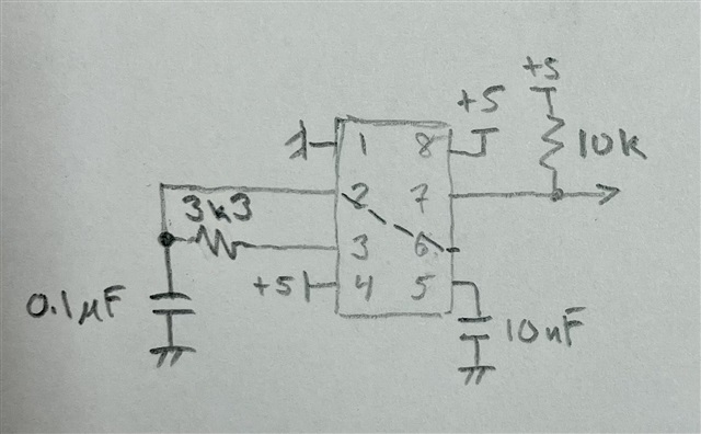

I’m using simplified 555 astable circuit:

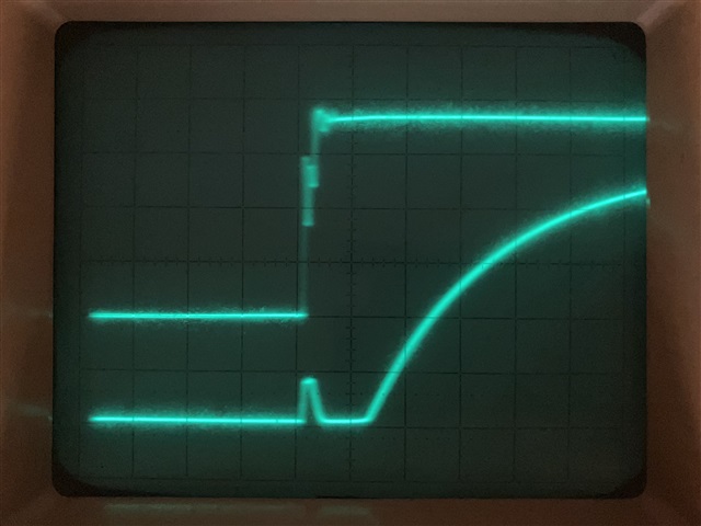

The output is this:
1v/div & 0.5usec/div. What’s that bump? It’s enough to be seen by 74HC gates.

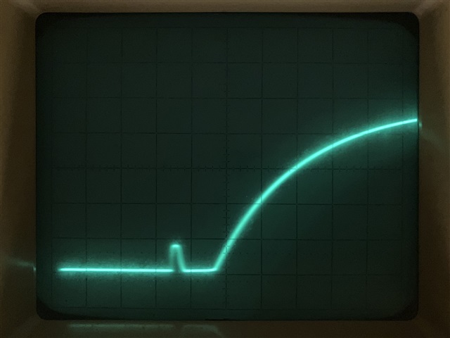

Hi Ron. I believe I have a bypass, I’ll double check, and also look at pin 1. This is on a breadboard. Here’s a bit more detail; top = pin 3, bottom = pin 7:
I assume there’s a current spike when the comparator flips; is that the likely source?
Thanks ~ J
J,
Yes, there is and that is the source.

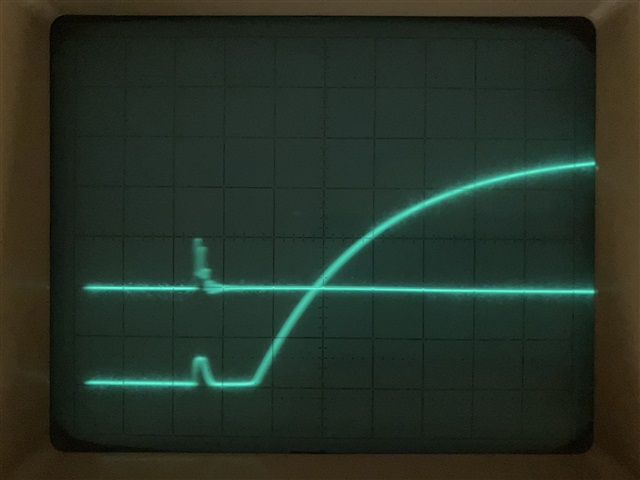

That's why I suspect bump is also on pin1 (keep scope ground where is has been).
Yes it is bypass. Here is pin 1 and pin 7 with no bypass:
Adding 0.1u bypass helps, but not much.

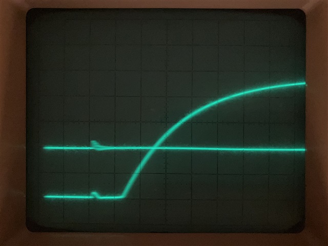

Here they are with 10u bypass:
This seems ok.
So the lesson is comparators might need larger bypass than you might think?
Thank you ~ J
