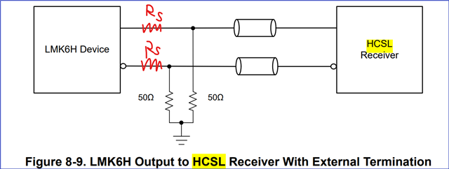

Hi Support
I have question regarding figure 8-9 LMK6H Output to HCSL Receiver With External Termination, Priori to simukation, I would like to clarify since It looks like different from standard HCSL termination from other vendor's application note. I am just wondering if there should be series resistors like my sketch? Or there is already build-in series resistor inside LMK6H?
* I am also attaching the application from other vendor.
