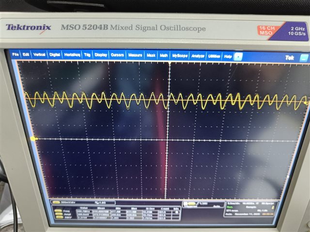

    The CPOUT (pin 14) is measured as below,
    The frequency also keeps increasing, but never becomes flat.
    VTUNE is measured at around 80mV as shown below,
    The 3.3V supply and SPI signals all look good.
     spi SDI
     SCK
    On the same board, there is another piece of working LMX2820, I measured the CPOUT as below,
  • Hi HR,
    CPout voltage is 1.3V in the working device, this is good, however there are 500mV AC signal as well, I hope this is just a measurement issue.
