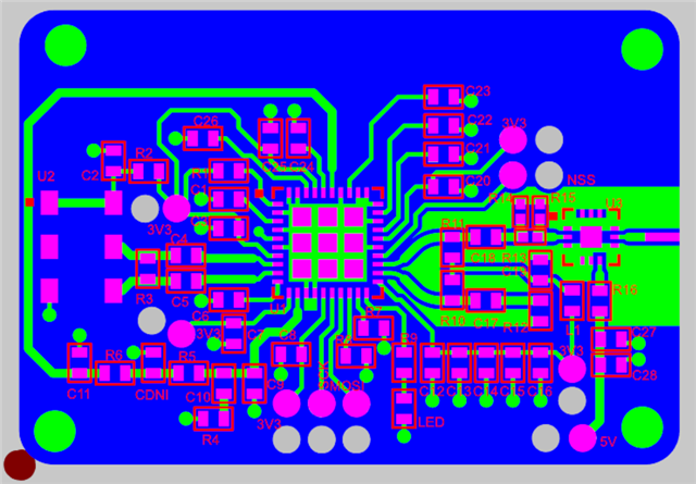

Hi Experts,
I am using LM2595 for generating a fixed frequency. I am attaching settings on TICS Pro and registers which i program in IC.
I am getting correct frequency, correct power from LMX2595. The problem  is the IC heats up very much during operation and power starts decreasing over time as circuit heats up and finally after 20-25 minutes, it stops giving frequency. What can be problem? Here is my registers file :
HexRegisterValues.txt
Marvin

    4 - I am attaching picture of PCB in which you can see that there are enough vias to distribute heat of LMX2595.

  • Hi Marvn,
    How many layer does this board have? Do you have a big GND copper plane to dissipate the heat from LMX device?
  • Hi Noel,
     The board is 2 layers and there are enough vias to dissipate heat from LMX2595 to ground plane
  • Hi Marvn,
    I assume the whole bottom layer is the ground plane, this is fine.
    I don't know what is wrong. Maybe you can try reducing the output power setting or move C11 closer to the Vtune pin.
