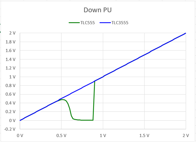

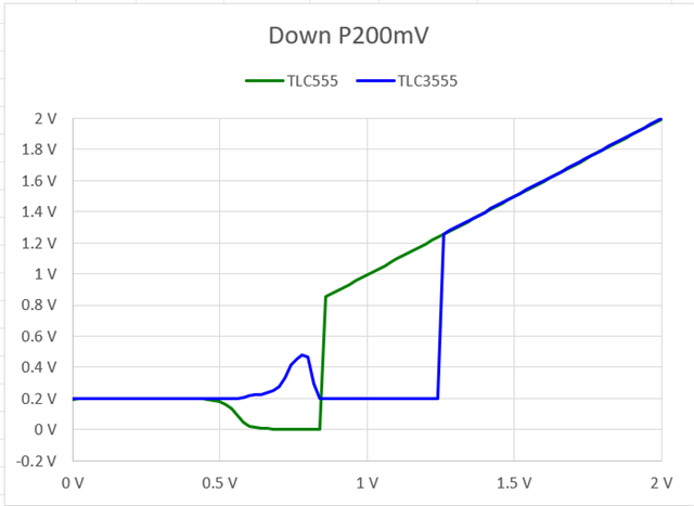

    For power down while asserting trigger and threshold while reset is high, TLC3555 sample data suggests no pulling low.
    First chart is VDD power down (moving left on chart) OUT has 100k resistance to 200mV (to see HI-Z output states)
    Second chart is VDD power down while OUT has 100k resistance to VDD (pull up)
    For output high all the way down, a pull up resistor is needed.
    Regarding the waveform in the diagram, is the green line the TLC555?
    VDD seems to maintain a high level up to 0.85V.
    The meanings of the X and Y axes are as follows:
    X-axis: Decreasing state of VDD (supply voltage)
    Y-axis: Voltage at the OUT terminal (VOUT)
    ttd
  • TTD,
    Yes.
    Yes.

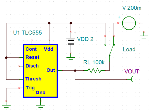

  • Hi Ron,
    Our actual measurements here show VDD dropping to Low around 1.6V, whereas the your test waveform maintains VDD at High up to 0.85V, resulting in differing outcomes. What factors could be causing this?
    Could you share your test schematic?
    ttd
  • TTD,
    This was my test circuit. VDD falls slowly, about 1-2 seconds.
