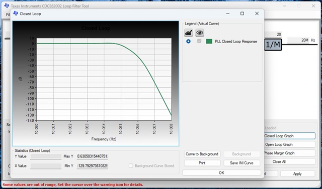

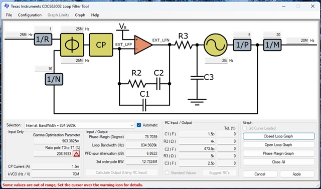

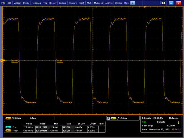

Hi, I have the CDCE62002EVM, I want to use it to generate a 1Ghz clock. I've been trying to familiarize with the board but:
1- Any time I try to change the frecuency, I use the CDCE62002EVM GUI 1.2.1 frequency planner, set the desire frequency apply the calculated settings and click Write, and then /PD Calibration and nothing, the output goes flat. I push the reset button and goes to the factory default configuration and the signal appears again. What are the steps sequence needed to change the output frequency? any frequency
2- I read that the CDCE62002 can generate a square signal (clock) but the signal I get with the factory settings are sine wave. How can I change to the square clock signal?
