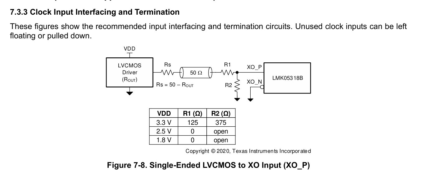

Dear Team,
Please find the attached below Images.
It is mentioned that for 3.3V termination resistors are 125E and 375E
My question is Can i use 125E part which has 5% tolerane in this place.
Hoping for the reply from your side as soon as possible.
