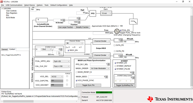

We would like to test SYSREF mode, as indicated in the user manual (p8 figures 9 and 10), by generating a signal on RFOUT B with a programmable delay (relative to RFOUT A), but we are unable to generate this output signal. Figure 10 does not show the signal frequency either (are we really at 100MHz output? With an OSCIN also at 100MHz?).
Our problem is that when we reproduce the PLL settings shown in Figure 9 as example, as soon as VCO_PHASE_SYNC is activated, the RFOUT A output unlocks (the output frequency is no longer 100MHz). The RFOUT B output remains off (no signal). Pressing ‘toggle SysRefFreq Pin’ or ‘Toggle Sync Pin’ causes the USBtoANY module to send only a high state (rising edge) but seems to have no effect on the RFOUT A and RFOUT B outputs.

  • Hi There,
    After checking the VCO_PHASE_SYNC bit, the N divider will change, we may need to program all register again.
    The INPIN_IGNORE bit needs to be unchecked otherwise the signal at SYNC and SYSREFREQ pin will be ignored.

    I went through the recommendation to disable (=0)  the INPIN_IGNOR , but I still facing the same issue.
    As soon as I activate VCO_PHASE_SYNC = 1, the RFOUTA output signal unlocks.
    However, I notice that I get an error when I activate ‘toggle SysRefReq Pin’: Python Error Pin ‘SysRefReq’ not found
    (this error does not appear for ‘toggle Sync Pin’). It could be related to my issue ?
    For information enclosed there are
    - screenshots of the error on TICS Pro SW
    - Register table
    - Oscilloscope signals on RFOUTA (green), RFOUTB (orange), and OSCIN (yellow) before and after activation of VCO_PHASE_SINC

  • Hi There,
    The unlock with VCO_PHASE_SYNC = 1 is due to the phase detect frequency being too high when IncludedDivide = 6, we can use the FCAL_HPFD_ADJ register to reduce the phase detector frequency being used during VCO calibration to less than 50MHz.
    Right, I see the same python error on my side, I will fix this. In the meantime, go to the User Control page to manually set the SYSREFREQ pin state.
