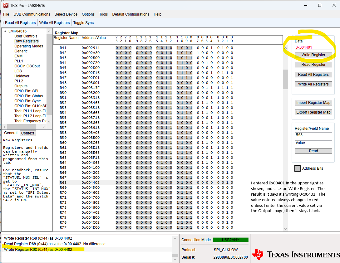

I can change Output settings for Divider 0&1 on the Outputs page between values of 1 and 2 successfully. Each time it says it's writing the expected value to R68.  But when I try to do the same thing from the Raw Registers page, it doesn't work.  If the value is 0x004401 and I attempt to change it to 0x004402 it displays in red and when I click on "Write Register" it writes 0x00 4401.  This seems to be the case for every register.  Connecting the same cable to another computer using TICSPro v1.7.7.2 and it works as expected; we can change the value from the Raw Registers page as expected.
Ultimately I was trying to do this from Python using the Python interface, and when I was having issues I tried from the GUI.  Same problem.  Is this a known issue?  Or could I have something configured incorrectly?Screenshot4TI.png
  • Further experimentation shows I can change the address portion of the register!  That is, for R2, if the current value is 0x00 0200 I can change it to 0x00 0300! Something is very broken. I should not be able to change the register's address, right?
  • Hi Serge,
    Right, the newer version TICS Pro has this issue. In the older version, we can change the data field value but not the address.
    A workaround, instead of writing to the Data box, we can change the bit value directly.
    Click on the bit that we want to change, type the value.
