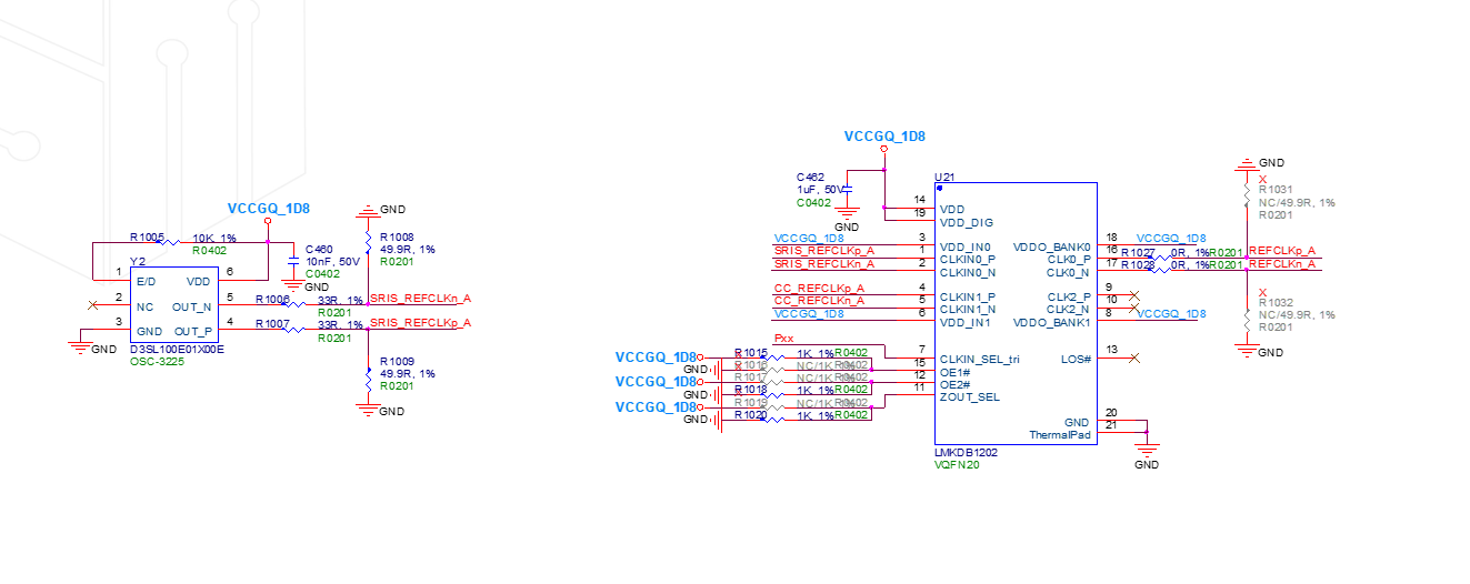

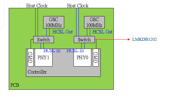

We needs to support switching between SRIS and CC modes at the system level.
The oscillator is 100 MHz with HCSL output, and the PHY uses a 100 MHz HCSL input.
Would you please review below application and shcematic? thanks!

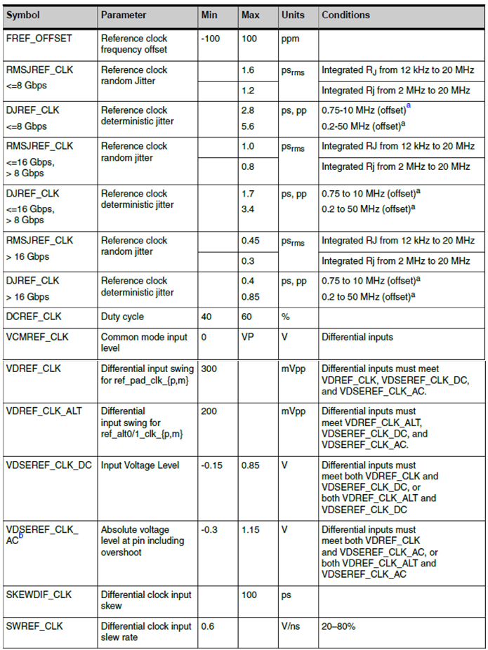

PCIe Phy RefCLK Input Spec
Schematic:
Jeff
  • Hi Jeff,
    Given outputs on LMKDB is LP-HCSL, you don't need placeholder for 50Ohm to GND termination on the outputs.
    I don't see the VDD filtering network - please check DS section 10.3 for more info.
    Vicente
  • Hi Vicente,
    Got it, thanl you!
    Jeff
  • Hi Vicente,
    Could you confirm whether this component is already the best fit for the application, or if there is a more suitable option available?
    Does the LMKDB1202 meet the specifications we provided for the OSC output and PHY input?
    Thanks!
    Jeff
  • Hi Jeff,
    This varies by customer application.
    Buffer has a noise floor and a certain amount of additive jitter.
    The main culprit here is the ref clk.
    The XO has an RMS jitter of 0.1ps
    The Rx accepts up to 1ps.
    Buffers will provide a certain amount of additive jitter for a certain integration band - we can also calculate the output jitter in this case.
    I don't expect LMKDB to provide 0.9ps of jitter.
    Should be okay for your application but customer can use PLLatinumSim to estimate output PN from the XO if they have a .txt file of the phase noise profile of that device and estimate time domain jitter.
    Vicente
