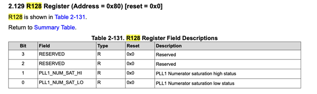

    I have a question: Do you have any information about register R128 (0x80)?
    When it takes time to lock, the value changes before and after the lock.
    However, the register information for R128 (0x80) is not described in the LMK5B12204 Register Programming Manual (Rev. B).
    Yoshinori
  • Hi Yoshinori,
    In the LMK05318B rev. April 2021 Programmer's Guide, R128 is mentioned.
    On my board, freq/phase locked R128 has 0x00.
    During holdover and locking progress it has also 0x00.
    If i understand well, it is the calculation limit indication like carry flag.

    I observed R128 on the board that takes time to lock.
    Before locking, it is 0x01.
    After locking, it becomes 0x00.
    I will investigate what is causing the flag to be set.

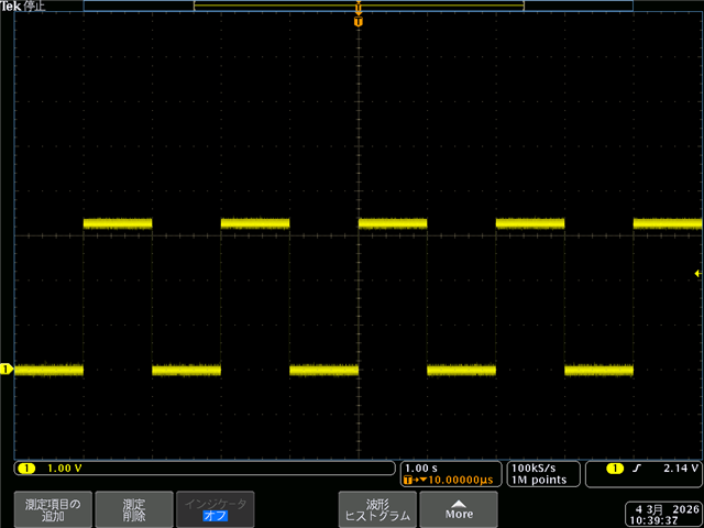

    I will check “DPLL R Divider, div-by-2” and “PRIREF Monitor Divider Output, div-by-2” next.

    1. I output “DPLL R Divider, div‑by‑2” to STATUS0 and observed it on the oscilloscope.
    As you mentioned, I was able to confirm a 2‑second period signal with 50% duty cycle.
    2. I output “PRIREF Monitor Divider Output, div‑by‑2” to STATUS0 and observed it on the oscilloscope.
    Similarly, I confirmed a 2‑second period signal with a 50% duty cycle.
    1.
    2.
    Is it reasonable to assume that there is no issue with the 1 PPS signal?
    Yoshinori
  • The observed values ​​and waveforms seem fine to me.
    According to the waveform, the AM6411's 1PPS signal is indeed following the leader, and the observed ±30 ppb should also be visible in the ptp4l logs, as this represents the 1PPS output. These are normal figures for ptp.
    The div-by-2 outputs (DPLL R Divider and PRIREF Monitor Divider Output) show no distortion. It's reasonable to assume there's no problem with the AM6411's 1PPS signal output.
    BTW: 1PPS from grandmaster shows an impedance mismatch. I think it is caused by high slewrate or un-terminated link. But it was only for triggering the scope.

    One thing I did discover:
    I output the following signals to STATUS0 and STATUS1:
    0x40 = DPLL R Divider, div-by-2
    0x41 = DPLL FB Divider, div-by-2
    When the device fails to lock, these two signals were 180° out of phase.
    After that, the phase gradually drifted, and I could see it attempting to adjust.
    When the device locks immediately, the 0.5 Hz signals were nearly in phase.
    How is the initial phase of the two signals determined?

  • How is the initial phase of the two signals determined?
    Outputs lock to selected input clock frequency.
    Outputs are un-muted if DPLL auto-mute enabled.
    Configured DPLL bandwidth is asserted.
    Output will have deterministic input-to-output phase
    relationship if Zero-Delay Mode (ZDM) SYNC is enabled.
    The datasheet shows "Zero-Delay Mode (ZDM) Synchronization" but it is actually the resetting of the output divider.
    The LMK05028 has true zero delay mode operation.

  • Hi Conner,
    Summary of Phase Measurements for STATUS0 and STATUS1
    STATUS0 : 0x40 = DPLL R Divider, div-by-2
    STATUS1 : 0x41 = DPLL FB Divider, div-by-2
    | Measurement Condition | Normal Board | Board with Long Lock Time |
    | OFF/UP *1 *3 | In phase | In opposite phase |
    | OFF/Lock *1 *4 | In phase | In opposite phase |
    | ON/UP *2 *3 | In phase | In phase |
    | ON/Lock *2 *4 | In phase | In opposite phase |
    *1 OFF means DPLL_REF_SYNC_OUT7_NDIV_RST_DIS (R252[6]) = 0
    *2 ON means DPLL_REF_SYNC_OUT7_NDIV_RST_DIS (R252[6]) = 1
    *3 UP indicates STATUS0 and STATUS1 were checked immediately after performing a software reset while 1PPS was being input to the LMK5B12204
    *4 Lock indicates STATUS0 and STATUS1 were checked when the LMK5B12204 achieved frequency lock
    The signals described as “opposite phase” are not offset by 120° or 150°, but are consistently 180° apart.
    Additionally, when the boards that take a long time to lock were warmed up before measurement, their results matched those of the normal boards.
    Yoshinori
