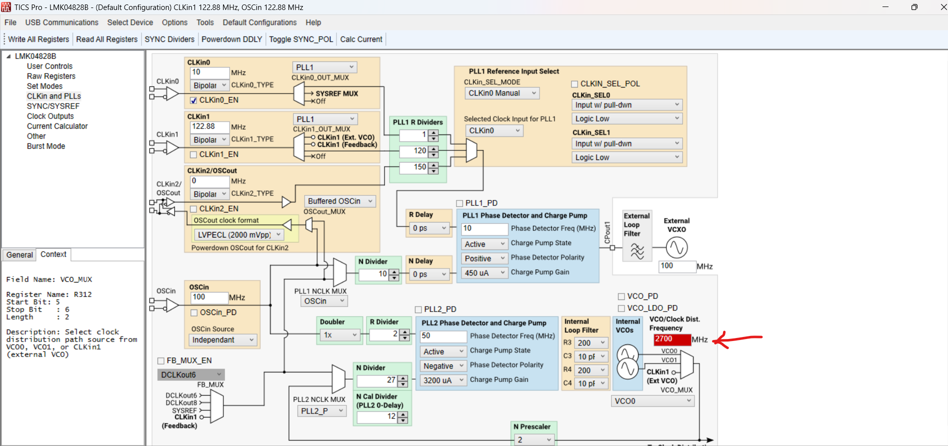

LMK04828-EP: TICS Pro Software Warning
Part Number: LMK04828-EP

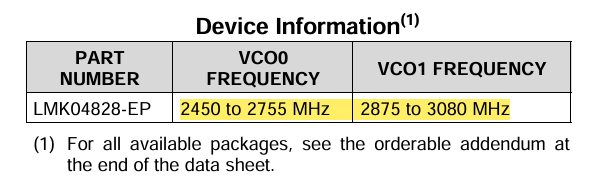

I am using the part number LMK04828-EP on my board and I need to achieve frequency of 2700 MHz on the output clocks as well as the Distribution clock (VCO frequency). For this I am using the TICS Pro Software Tool with selected device as LMK04828B. As seen in the screenshot, I have my OSCin independant source coming from a 100 MHz VCXO , and I am generating 2700 MHz frequency with appropriate R and N divider values for PLL2. But as seen although VCO0 is supposed to support frequency range of 2450 to 2755 MHz, I am getting a highlighted red colour in the VCO frequency when VCO0 is selected for VCO_MUX. Please let me know if this warning can be ignored considering the values in the LMK04828-EP datasheet.image.png
Thank you & Regards,
