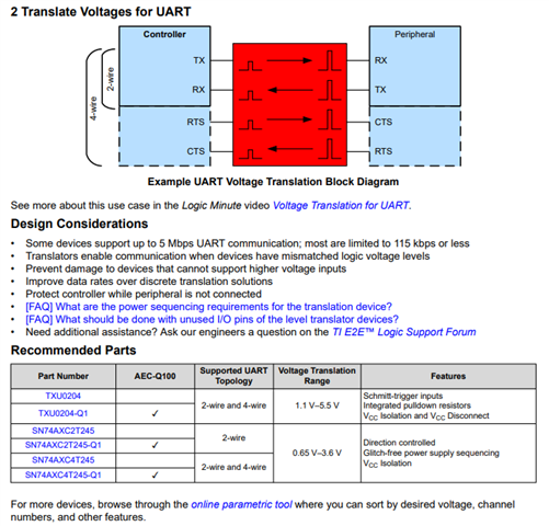

Hi Team,
I was planning to use the TXB0 series level translator in the design.
The TXB0102 is an auto-direction level translator intended for push-pull buses. However, it is generally not recommended for control signals that include:
• Pull-up or pull-down resistors
• Long trace routing
• Slow signal edges
Since the current design includes pull resistors and isolators in the signal path, a TXS0102 or a simple buffer is typically preferred in such cases.
Could you please confirm whether I can proceed with the TXB series level translator, or if it would be better to select the TXS series for this requirement
