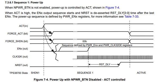

  • Hi Ash,
    Thanks for the additional information.
    The ACT pin of the TPS38700 controls up/down sequencing and all times are relative to the ACT transition (from LOW to HIGH or HIGH to LOW).
    The TPS38700 is a one time programmable (OTP) device which means that the default configuration is burned onto the chip and any further configuration can be done via I2C. However, please note that this device does not have NVM, so any changes made during operation will be reset and the chip will default to its OTP configuration on each power cycle. This device can support up to 12 channels and sequence timing registers can be found in the register map at the addresses shown below:
    If your application can accept a maximum sequencing time of 255.5ms and a -40C to 125C temperature range, the TPS38700 sounds like it fits what you are looking for.
