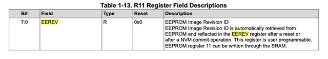

  • Thank you Connor, but than I have a followup question about EEREV.
    According to LMK05318B register manual SNAU254A R11 EEREV is read only.
    How do we change EEREV value?
    I understand that it can be written through SRAM but what would then be the sequence?
  • Hi Octo,
    EEREV is stored in EEPROM address 11, but like you mentioned it can't be directly written using the regcommit sequence since register R11 is read only. The easiest way to write this through SRAM is using the TICS Pro GUI, if you check the box to modify those restricted fields then you can see some additional writes get appended near the end of the programming sequence:
    This procedure follows the steps outlined in the "Write SRAM Using Direct Writes" section of the datasheet. For example to write a value of 5 to EEREV (EEPROM address 11) in my example, the sequence would be:
    R159 0x009F00 #Write MSB of EE address 11 to MEMADR byte 1
    R160 0x00A00B #Write LSB of EE address 11 to MEMADR byte 0
    R162 0x00A205 #Write data value of 5 to RAMDAT
    After programming EEPROM with the SRAM contents, on the next power cycle you can read back R11 and it should have the updated value stored in EEREV.
