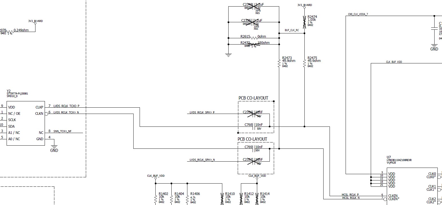

in our design we use LMKDB1104.
we use LVDS clock, use AC couple 10nF and use 100Ohm termination P to N.
we don't change RX_EN_AC_INPUT register value. default is '0' meaning DC couple.
does this design is not according to spec and can cause issues? if so what kind of issues?
