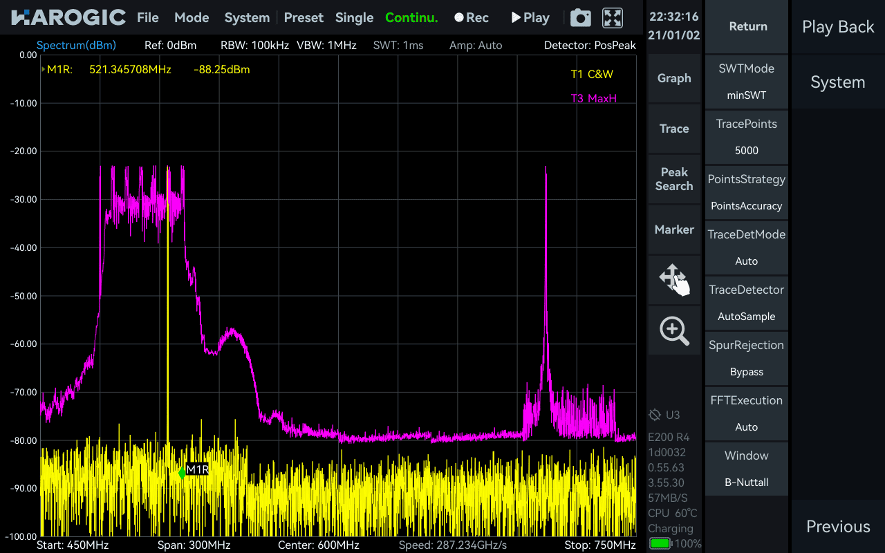

ramp pulse count = (fvc stop frequnecy - fvco start frequency)/step size
I observed that its just ramping from 485MHz to 521MHz, even though we are sending 3520 pulse
pulse count = (11200-7680)/1
                    = 3520 pulses
Could you please explain why is this happening ?
but if I send double (3520*2) pulses I get full range (480 to 700MHz).
  • Hi There,
    If the 1MHz step size is at VCO frequency and the ramp clock frequency is low (e.g. 10kHz), then 3520 ramp clocks are enough.

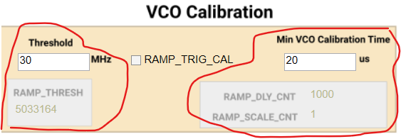

    We can setup a threshold and pause time (for VCO calibration) to make the time taken for calibration more deterministic.
    Whenever the accumulated ramp frequency reach or over the ramp threshold, the device will calibrate automatically.
    For example, we can make RAMP_THRESH = 30MHz and pause time = 20µs.
    Then there will be 3520 / 30 = about 117 calibrations. Each calibration takes 20µs, the total calibration time is 117 x 20 = 2.34ms. Given ramp time is 17.6ms (for 3520 ramps), the total ramp duration is 2.34 + 17.6 = 19.94ms.

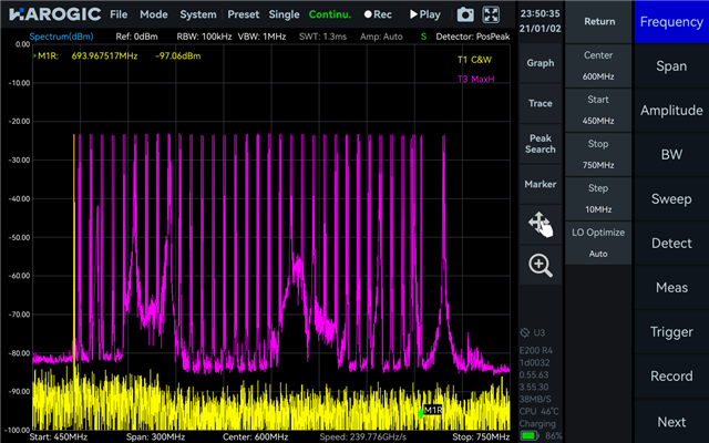

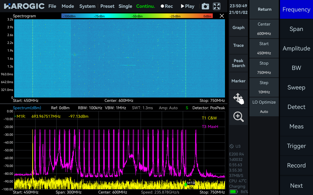

    I have two queries:
    1. In automatic ramping, what determines the step size, and what is the minimum possible step size that I can use?
      I am ramping from 480 MHz to 700MHz with current setting and configurations I am seeing 7MHz of step size. (what parameter decides this step size)

  • Hi There,
    In automatic ramp, the frequency is incremented once every fpd cycle (or 2x fpd cycle when RAMPx_DLY = 1).
    From "desired duration" and fpd, we know how many ramp (RAMPx_LEN) are required. For example, if fpd = 100MHz and the desired duration is 100µs, then there are 10000 ramps, from the start frequency to the end frequency. Given the number of ramp and the ramp range, we know the step size of each ramp.
