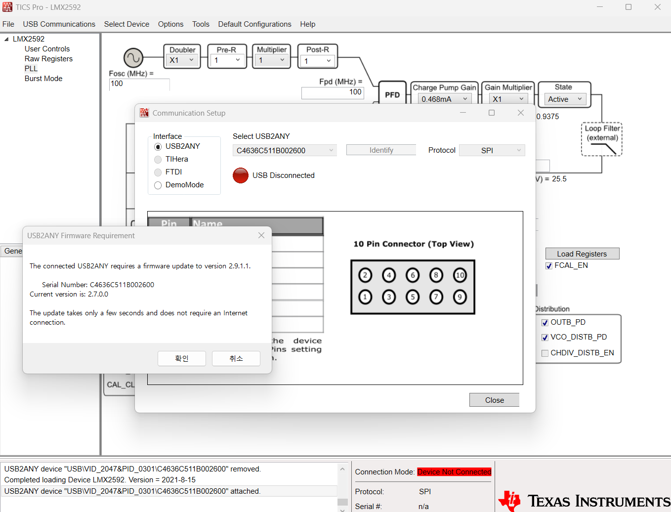

I have an LMX2595EVM with the included Reference Pro board (LMK61PD0A2). When I connect the Reference Pro via USB and launch TICS Pro v1.7.9.1, the software detects the USB2ANY interface and shows the following prompt:
"The connected USB2ANY requires a firmware update to version 2.9.1.2.
Serial Number: C4636C511B002600
Current version is: 2.7.0.0"

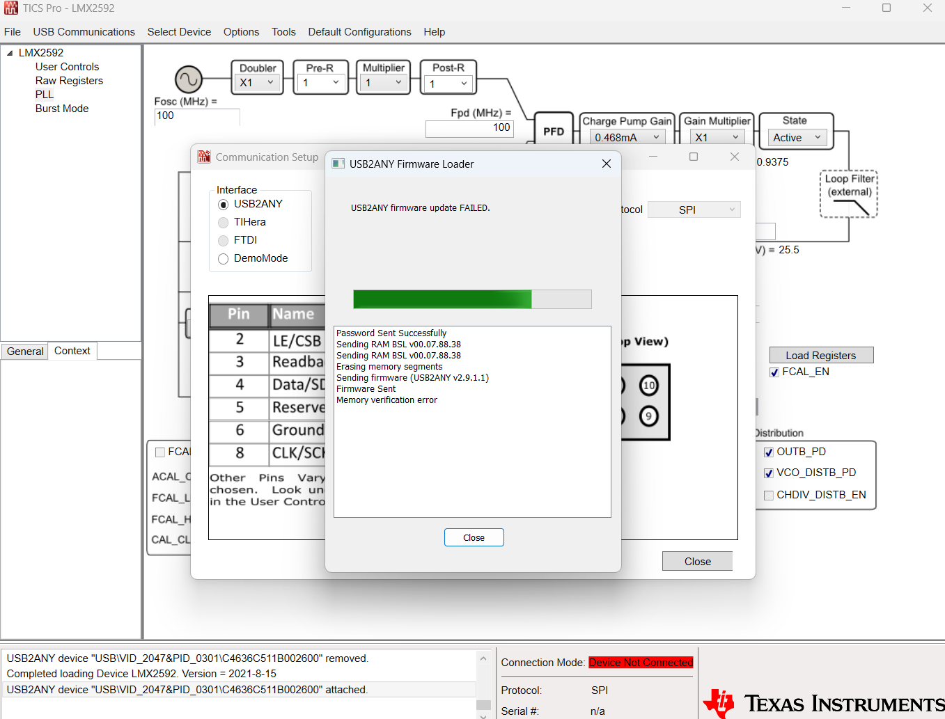

When I proceed with the update, it fails with "Memory verification error." The log shows:
- Password Sent Successfully
- Sending RAM BSL v00.07.88.38
- Erasing memory segments
- Sending firmware (USB2ANY v2.9.1.2)
- Firmware Sent
- Memory verification error
- USB2ANY firmware update FAILED.
After this failure, the board still enumerates as USB2ANY in Device Manager, and both LEDs (MSP430 supplied and LMK61xx supplied) are lit. The current firmware v2.7.0.0 appears to still be intact, but TICS Pro refuses to communicate (shows "Device Not Connected") because it requires v2.9.1.2.

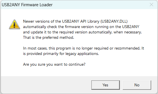

    1. Download USB2ANY Firmware Loader (https://dr-download.ti.com/software-development/firmware/MD-063xo7KvuK/01.00.00.00/snvc166.zip), unzip the .exe file to a folder.
    2. Copy USB2ANY.dll from C:\Program Files (x86)\Texas Instruments\TICS Pro to the same folder of firmware loader. For example:

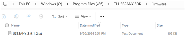

    3. Save below text file to c:\Program Files (x86)\TI USB2ANY SDK\Firmware.
    6560.USB2ANY_2_9_1_2.txt
    4. Connect Reference Pro board to the PC via USB cable
    5. Run USB2ANY Firmware Loader.exe
    6. Click Yes
    7. Click Cancel
    8. Click Update Firmware. Make sure the correct text file is shown in "Update to firmware" pull down menu.
    9. Click Yes
    10. Follow the onscreen instruction to complete the update.
    I hope this works.
  • Unfortunately it still gives the same error (memory verification error)
    I'll look for Win10 device.
