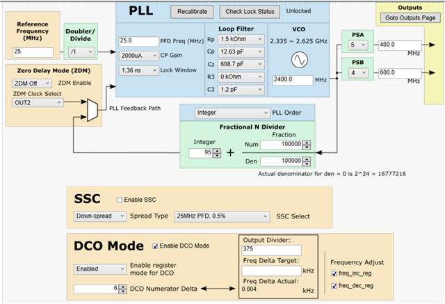

    Based on my understanding, I would then configure the device as in the picture below, this would give a sub-ppm step size on the ADC clock.
    1) Follow up question regarding the DCO Mode fields in the black rectangle: Output divider and Freq Delta Target are not really configuration fields on the device, they are just to there for help the calculation of what the frequency change will be, correct?
    2) It seems that there is no factory configuration to pass a 24MHz XTAL reference to an output at startup that can later be adjusted through the DCO, correct? (We have to write a configuration to eeprom first)

  • Hi Tobias,
    Just wanted to get back to you regarding the behavior of DCO mode for the CDCE6214. I ran a setup in our lab with the same TICS Pro configuration and these are my findings:
    • The Output Divider and Freq Delta Target fields on TICS Pro are for calculating the DCO numerator delta, which will give you the incremental step size on each rising edge
      • The Output Divider value is the VCO frequency divided by the output frequency. So if your VCO freq = 2400MHz and your output is 24MHz, this should be set to 100.
    • This increment can go in the positive or negative direction depending on whether freq_inc_reg or freq_dec_reg is changed
    • The output frequency will increment/decrement in DCO mode during a 1 --> 0 transition of freq_inc_reg/freq_dec_reg, and the step size can be configured using your desired frequency delta target (in your case this would be ±1-10ppm)
    • The PLL Order of the N-divider should be set to "Frac Order 3" because DCO mode works by adjusting the numerator of the sigma-delta modulator

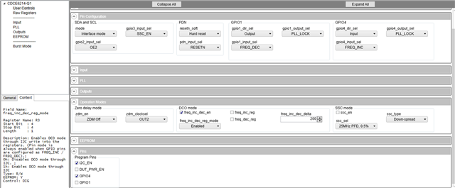

    I would now like to examine the clock behavior after we give a freq_inc signal to the CDCE6214.
    With your evaluation kit I can't seem to get the hardware signal input on GPIO4 to trigger a increment for the DCO. Register mode triggering works. What am I missing? Here is the configuration:
    I measure 1.8V on the GPIO4 floating, that's probably an internal pull-up. I then pull it low and release it with the jumper. The idea is to use this as the trigger for the oscilloscope looking at all the signals.

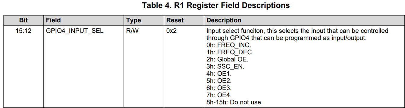

  • Hi Tobias,
    In the register dump I sent you, I had not configured the GPIO pins properly since I was incrementing/decrementing using I2C, so when you write to EEPROM the GPIOs will not be properly configured as FREQ_INC/FREQ_DEC in pin mode. If you are looking to use GPIO4 as your increment or decrement, you can update this raw register according to the CDCE6214-Q1 register map while connected via I2C, write the registers to EEPROM, then boot in pin mode to use the GPIOs.
    Based on the register map and the register dump I sent you, GPIO2 should be configured as FREQ_DEC as well, so it may be worth it to check whether this GPIO will decrement the output as well.
    Jaryd
  • Thanks a lot, but unfortunately I still didn't work.
    I configured the pins as Input, wit DEC and INC functionality, activated the pins. Had HW_SW_CTRL floating, commited everything to eeprom. Started the device from EEPROM page 0, by setting HW_SW_CTRL low. Then, set the jumper on GPIO4 to pull down, and connected and released, to VDDREF, verified with a voltmeter. The cdce6214 did not change the frequency.
    Could you send me a working configuration from your end. Attached is my configuration...
    Many thanks!
    CDCE6214_dco_mt.tcs

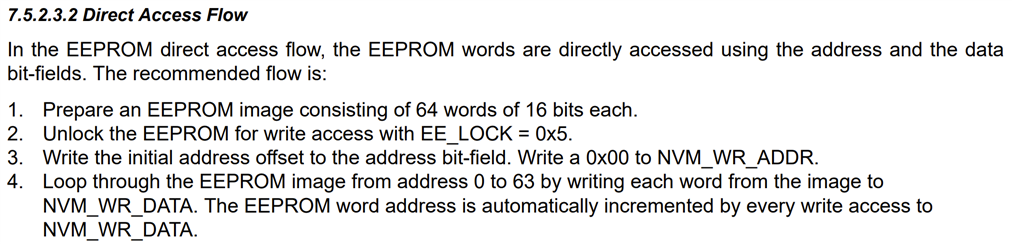

  • Hi Tobias,
    According to the CDCE6214 register map, the device mode register can only be written to EEPROM using the direct access method.
    The process on how to write using the direct access method is listed in the datasheet, I've attached the section below for convenience.
    Here is the step-by-step process to program the EEPROM in pin mode that I performed:
    1. Configure device in fallback mode (SDA/SCL pulled up, HW_SW_CTRL floating)
    2. Load TICS Pro configuration (.tcs)
    3. Set EE_LOCK = 0x5
    4. Set NVM_WR_ADDR = 0x00
    5. Set mode (R0[0]) to 0x1
    6. Configure other device settings as desired
    7. EEPROM >> Register to EEPROM
    8. EEPROM >> Read EEPROM to file
    9. Open EEPROM image in notepad and increment the hex AND decimal values of line 16 (page 0) or line 40 (page 1) by 1
    10. Write file to EEPROM with the edited .hxt file
      1. NVM_WR_ADDR should now read 63
      2. There may be a CRCERR, but it should still write to EEPROM
    11. Boot the device into pin mode - float GPIO2/3, set HW_SW_CTRL low (page 0) or high (page 1)
    12. Device should now be in pin mode with the selected page and proper EEPROM configuration
    With these steps I was able to observe OUT1's output frequency increment when I pulled GPIO4 down. The increment step itself was unstable and inaccurate, but this is likely because I used jumper pins to pull GPIO4 low since this method introduces lots of ringing to the pin. For more accurate increment/decrement, it is best to send the FREQ_INC or FREQ_DEC signal through an external microcontroller or ASIC.
    Here is the EEPROM file that worked on my end: cdce6214_dco.hxt
    To write this to your device, you can use steps 10-12 in the above process. I've configured the EEPROM image for the following settings, but if you'd like to change them, the steps above should work.
    Jaryd
  • Thanks Jaryd, this approach worked
