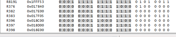

    Of course, TICS Pro does not make it easy to test this procedure, as the relevant registers are undisclosed and not included in the device profile. If you are performing SPI reads and writes through your own programming stack, this isn't an issue. For evaluation with TICS Pro, the device profile must be modified:
    1. Open the file C:\ProgramData\Texas Instruments\Tics Pro\Configurations\Devices\Clock Generator-Jitter Cleaner (Dual Loop)\LMK0482x\LMK04828B\LMK04828B.ini
    2. In the [REGISTERS] section:
      1. Add six to the value of the COUNT key. e.g. COUNT=136 should be updated to COUNT=142.
      2. Anywhere in the section, add the following data (substituting the range 136:141 in keys for the values <COUNT-6>:<COUNT-1> as appropriate):
        NAME136=R376
        MASK136=0
        VALUE136=96320
        NAME137=R382
        MASK137=0
        VALUE137=97792
        NAME138=R383
        MASK138=0
        VALUE138=98053
        NAME139=R396
        MASK139=0
        VALUE139=101376
        NAME140=R397
        MASK140=0
        VALUE140=101632
        NAME141=R398
        MASK141=0
        VALUE141=101888
      3. If TICS Pro is open, close TICS Pro or switch to a profile other than LMK04828B.
      4. If there is a file C:\ProgramData\Texas Instruments\Tics Pro\Configurations\Devices\Clock Generator-Jitter Cleaner (Dual Loop)\LMK0482x\LMK04828B\LMK04828B.tcb, delete it or remove it from the directory.
    3. On subsequent access to the LMK04828B device profile, TICS Pro's raw registers should now expose the relevant registers at the bottom of the page.
