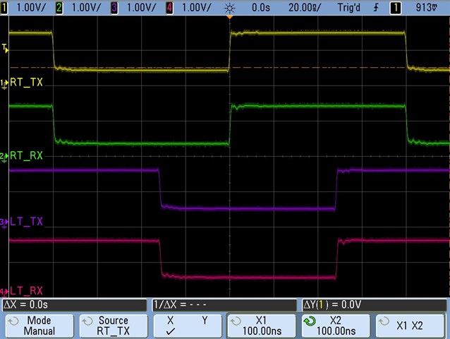

  • I increased the sync pulse to 150ns. Instead of writing 0xD1 to 0x143 in step 1, if I write 0x11, I can see the pulse flow through to sysref output. I did this just to confirm that the chip is seeing the sync pulse.
    The third trace from the top is the pulse going to the chip, and the fourth one is sysref out of the chip (the top two are sysref from LMK1 chip that I use as a reference). It looks like there is a bout a 16ns delay for the pulse to go through the chip.
    Why toggling SYNC_POL causes a sync but a 150 ns pulse does not? SYNC_POL is a lot longer as our SPI accesses are very slow. Since we are setting the 1shot bit, only the rising edge should matter.
  • This is just a visual of what I am seeing. The top two are the same sysef signals from LMK1. The bottom two are from LMK2. I can assert the sync (now 150ns wide) anywhere in this window, and the relative position of the two does not change:
  • And now I do a sync with SYNC_POL instead, and the relative position of the two move. If I keep doing this, the two randomly move with respect to each other because SPI accesses happen at random time.

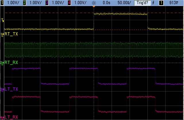

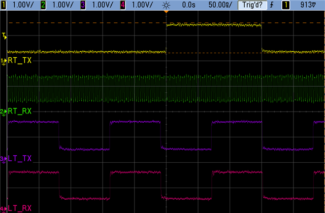

  • Here is a visual of what I am seeing:
    The top signal (yellow) is the sync signal: 150 ns wide now.
    The next (green) is the LMK 312.5MHz clock output: still running when sync is asserted.
    The bottom two are sysref from other LMK.
    Here I have moved the sync pulse by 20 ns. You can tell that by how much it moved with respect to sysref of the second board (the two bottom signals) as that reference is not moving. recall that at this point sysref output of the two LMK devices are locked to each other with a random phase. So, if sync is moving with respect to second LMK, it is moving the same amount for the first LMK.
