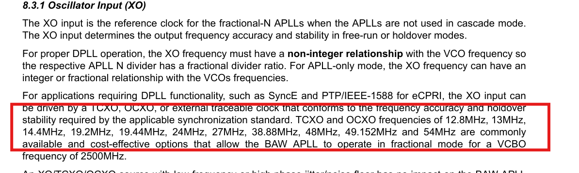

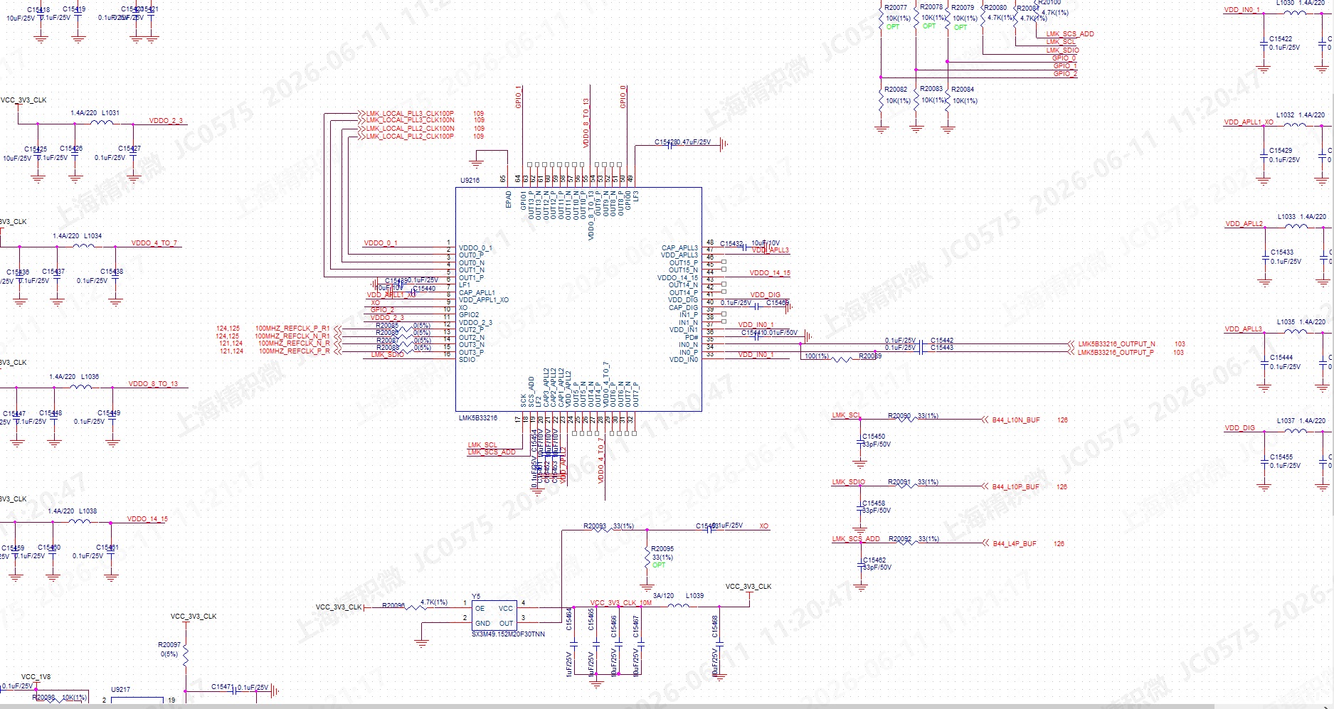

Can we select a 10MHz clock for the OCXO here
Please help review the shcematic
Sky

    Yes you can use a 10MHz OCXO as an XO input as long as the frequency has a non-integer relationship with the VCO frequencies of each of the APLLs (if the DPLLs are being used).
    I will review the schematic you've sent and get back to you with feedback in the next few days. In the meantime, would you be able to send a clearer image or a PDF of the schematic?

    I have reviewed your schematic and based on what I can see, the schematic looks good for the most part. My comments are below:
    • Ensure the 0.1µF supply filtering capacitors are placed close to the device pins in the layout.
    • The recommended capacitor value for CAP_DIG is 10µF.
