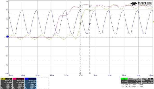

I'm facing a very strange issue whent I try to cat 3 sync 2 pll sharing the same clock.
the setup is the following: 2 pll sharing the same 100MHz clock and same sync signal. the timing between the sync signal and the rising edge of the clock is granted by a D FFlop triggering on the rising edge of the clock SN74LVC1G79DCKR.
On the output of the two PLL I have a mixer to detect the phase between them.
The output frequency is from 2400 to 2500MHz.
Problem description:
If I set my frequency between 2400 and 2475MHz the phase sync is reliable and i can see on the scope with infinite persistance the output of the mixer as a fixed level DC signal.
Yellow mixer output
red sync signal
If I set my frequency from 2478 to 2499MHz the the sync is no more reliable and the output of the mixer can assume 2 or more levels.
at 2500MHz the phase synch return reliable.

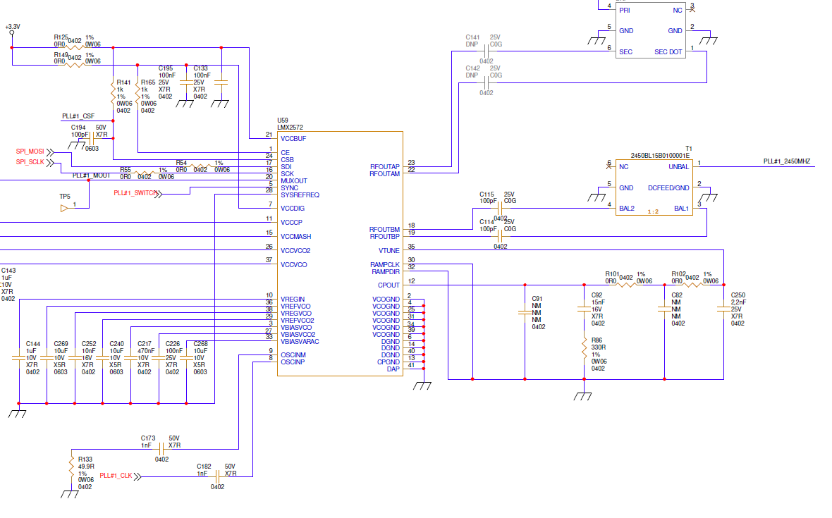

this is  the schematic:
Do you have any idea of where to look at?

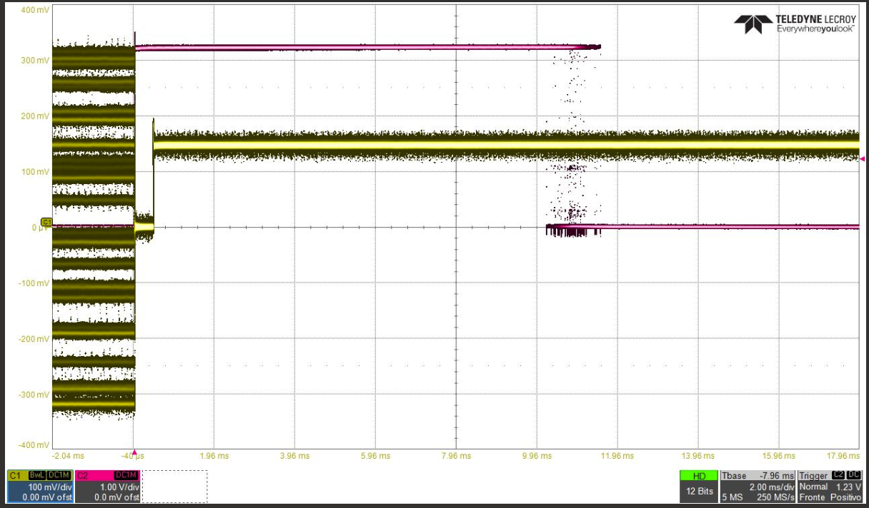

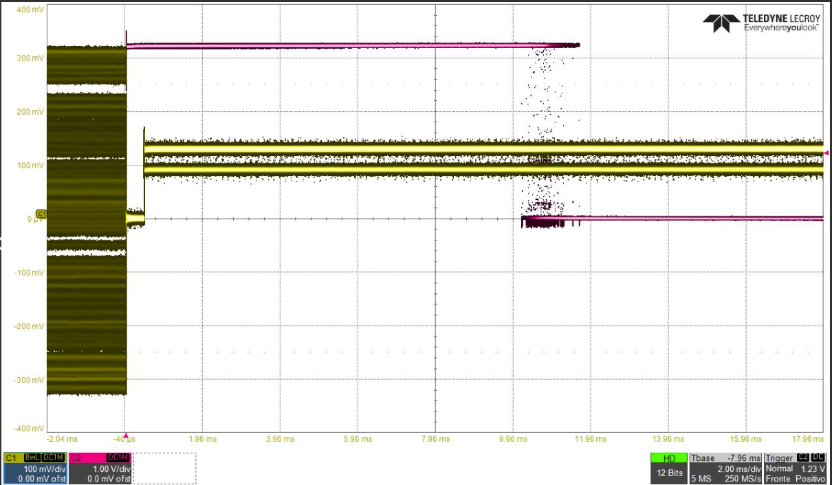

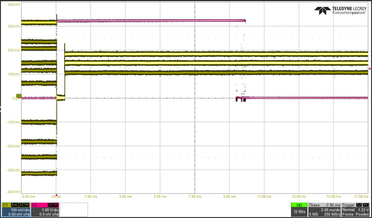

  • I apologize for the misunderstanding.
    following are required registers configuration of 2 channels after the sync signal:
    CH7 CH8
      R112 (0x70): 0xFEAF   R112 (0x70): 0xFCB9
      R111 (0x6F): 0x014C   R111 (0x6F): 0x0143
      R110 (0x6E): 0x0C88   R110 (0x6E): 0x0C88
    Second try
    CH7 CH8
      R112 (0x70): 0xFEAE   R112 (0x70): 0xFCB9
    3rd try
    CH7 CH8

    this is the Sync signal timing:
    blue: clock
    red: synch signal (D FlipFlop input)
    yellow: clocked sync signal (D FlipFlop output, LMX2572Input)
    the oscin rising edge happens 6.6ns after the rising edge of sync signal

  • Thank for your help.
    I've increased the MASH_RST_COUNT and now the phase sync process seems to be reliable.
    As you can see after the sync signal (red) the output of the phase detector takes all the times the same value.
    After sending the phase shift command the output of the phase detector reach its maximum value (1.75V) so both signals are in phase
