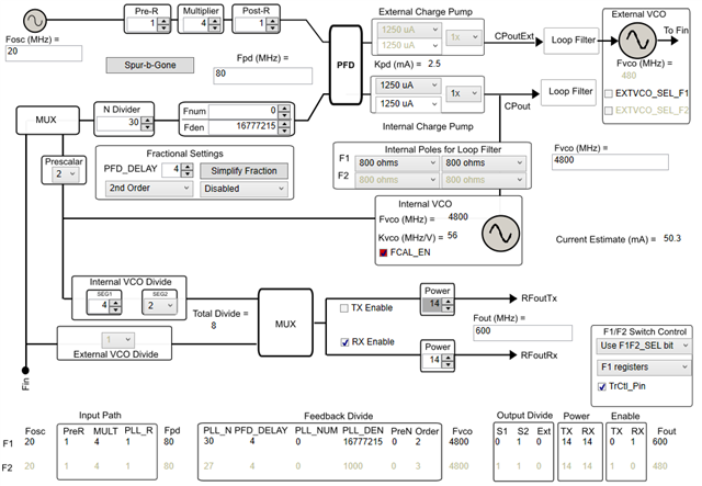

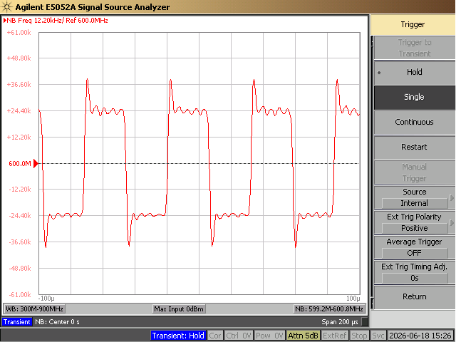

    I don't see any reason why the wait time needs to be >1ms. Programming of R34 only take 3.7µs, you have more than 30µs until programming the next R34.
    For example, in below plot, the interval between programming R34 is 22.22µs.
    This is my test setup.
