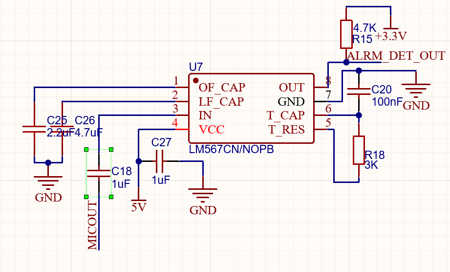

Currently I am using the LM567C IC for detucting the particular frequency (3KHz). But when i play the audio of 3KHz frequency, the circuit does not detucting it. Here i attached the Circuit diagram i used.
  • Hi Aakash,
    Sorry for the delayed response here, this is a legacy device so it didn't immediately get assigned to our team. Were you able to get this circuit working? I didn't notice any obvious issues with your schematic. What is the amplitude of the 3kHz input?
