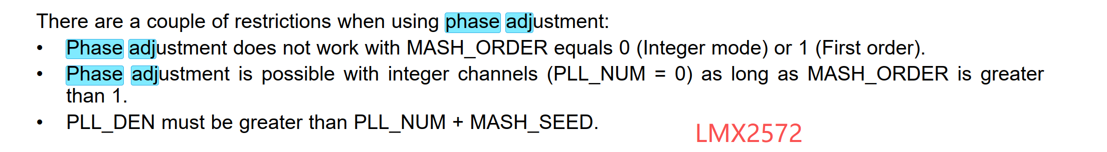

Hi Teams,

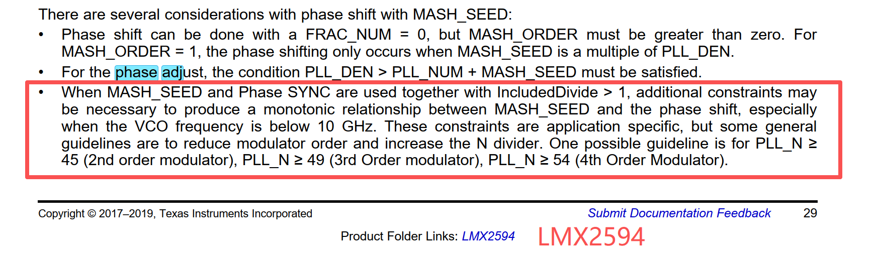

I saw in https://e2e.ti.com/support/clock-timing-group/clock-and-timing/f/clock-timing-forum/1544486/lmx2594psevm-sync-and-mash_seed-function?tisearch=e2e-sitesearch&keymatch=LMX2820%25252525252525252520SYNC when LMX2594 SYNC is enabled, MASH_SEED will become unstable.
However, when I check the datasheet of LMX2572, the phase adjustment section did not say same thing as which in LMX2594 datasheet. I want to confirm will the LMX2572 have same problem or not. Since LMX2572 have the includeddivide too, I am afraid it is the same as LMX2594.
Best Regards
  • Hi There,
    The channel divider and IncludedDivide are different in LMX2572, that monotonic characteristic in LMX2594 does not happen on LMX2572, at least, we haven't found a configuration can replicate this problem so far.
