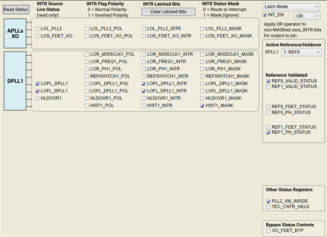

    I'm currently stuck on 2.5.2 - Debug DPLL Frequency Lock. I get a valid XO and REF, the values in TICS pro 'Inputs/DPLL Frequency' seems reasonable. I've tried widening the frequency validation thresholds without any lock, which may be a clue. Even after setting it to unreasonable values. I'm having a bit of a trouble uploading a screenshot of my status registers (hopefully it works), but the LOPL_DPLL1 and LOFL_DPLL1 are both set. Otherwise the status registers seem fine (REF_VALID_STATUS set, REF_FDET_STATUS and REF_PH_STATUS cleared). Changing the reference frequency also does uncheck REF_VALID_STATUS - Changing it back sets it.

  • Thanks for sending over your config file, I don't see anything obvious that would prevent the DPLL from locking. Early next week I can try this out on my setup to see if I can replicate the same behavior. In the meantime, can you also try reading back APLL1_NUM_STAT when the DPLL is attempting to lock to the 1pps input? You should see the num stat value is constantly updating to keep the VCO locked to the reference input. Ideally, it should be somewhat close to the default APLL numerator value. If it has a very large delta that could indicate that the 1pps reference has a large frequency error compared to the 48MHz TCXO.
