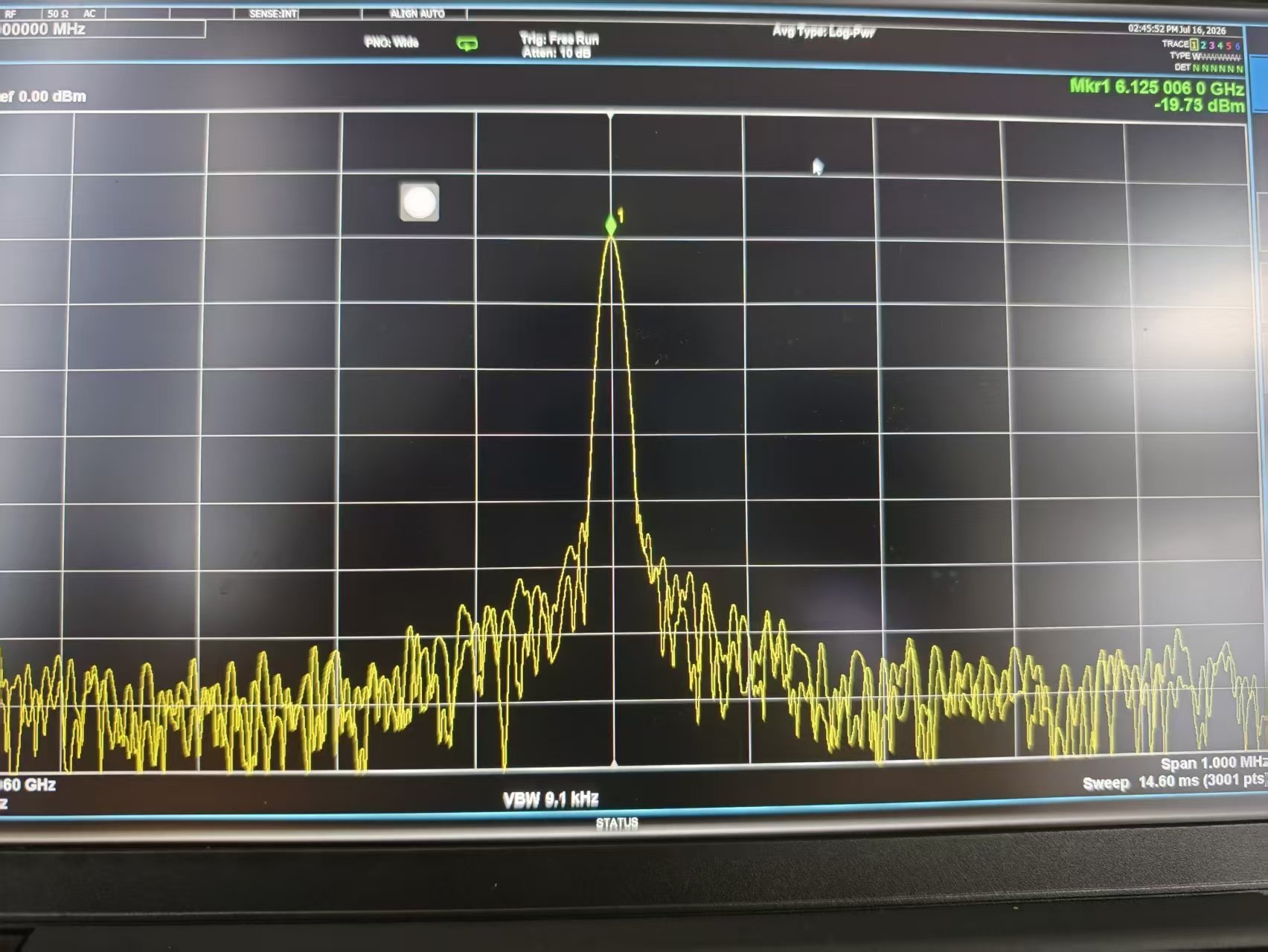

Next, we send SPI commands via the FPGA to reconfigure the LMX2820 to output 6125 MHz signal. The LMX2820 successfully outputs this frequency, and the LD signal remains high. Please see the attached spectrum analyzer screenshot for the test results.

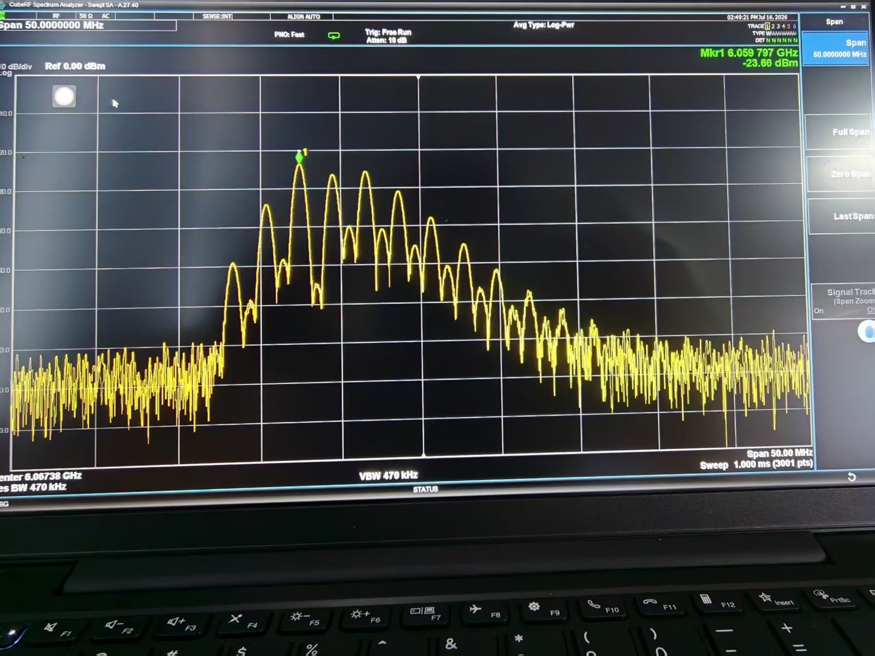

At this point, the LD (Lock Detect) signal of the LMX2820 remains low, indicating an unlocked state. Furthermore, the output frequency of the LMX2820 is not the expected normal 6125 MHz. Please refer to the spectrum analyzer screenshot below for the test results under this condition.
What could be causing this unlock issue? Alternatively, could you please provide the correct procedure for using full assist calibration? Thank you!
  • Hi There,
    Your procedure to read back and use the VCO parameters is correct.
    When using full assist mode, did you program other initialization registers?
    Another thing to try.
    (1) program the device to lock at a certain frequency with no assist
    (2) read back the VCO parameters
    (3) apply the VCO parameters but do not set the _FORCE bits. (The device should remain lock)
    (4) set the _FORCE bits one by one (The device should remain lock).
    (5) power down the device
    (6) power up the device, program all the registers using the register set in (4). (The device should lock).
