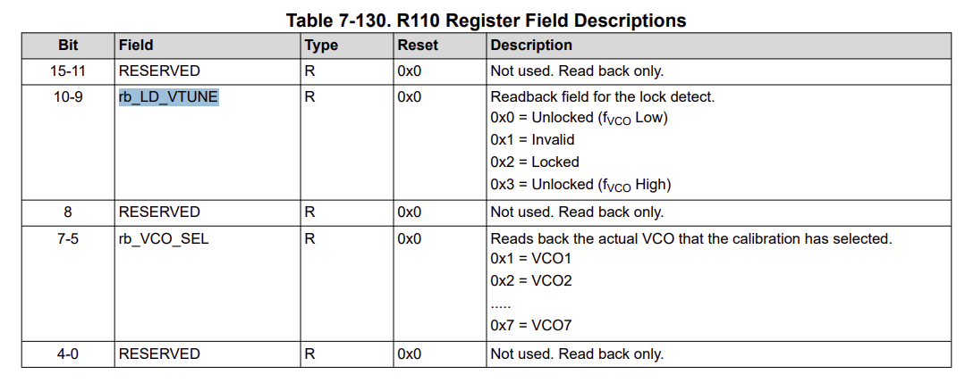

Dear Team,
I am using LMX2694SRTCTEP, When reading Register R110, i obtain a value of 0x0759 (binary: 0111 0101 1001).
According to the LMX2694 datasheet, bits [10:9] indicate the VCO status, and the reported value corresponds to "Unlocked (fVCO High)".
Could you please help us understand the possible reasons for this condition? We would also appreciate your guidance on the recommended debugging steps or any configuration changes required to resolve this issue and achieve a stable PLL lock
