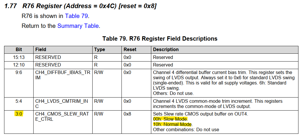

In our design, we use your CDCE6214RGET with all available channels. While consolidating the user's guide (CDCE6214-Q1 Register Map) to determine the desired configurations, I noticed an issue with the configurable CMOS Slew Rate for CH1 (Register R60) and CH4 (Register R76). Each register holds four bit for the corresponding slew rate control. The provided setting for "Normal Mode" however is 0x10, which is not valid. Therefore I kindly ask for clarification.
