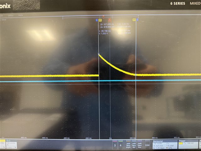

We are using LMX2694 to create a 9280 MHz clock from a 300 MHz osc in. We notice that the LMX2694 reports it's "locked" per R110 (readback = 0x0448). However, we notice on triggering the calibration that its output starts at 9280 MHz and drifts over the course of 20 seconds or so to 9200 MHz. Also, when we probe VTUNE, either with an oscilloscope or a DMM, the output frequency of the LMX2694 jumps up to ~9400 MHz. The DC value of V tune is about 365 mV.
image.pnglmx2694.txt
  • Another item to note, after the initial drift, if we halt the OSC_IN signal, the output of the LMX2694 is unaffected, indicating to us that the VCO is essentially free running. The output frequency is also very sensitive to temperature after the initial transient.
  • Here is an image of the VTUNE node versus time. When the calibration is triggered
